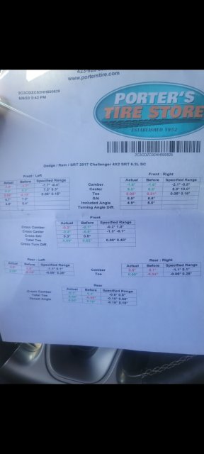

What does your camber look like in the rear?
You've got a lot of power, you're not squatting down on your inside tire edges and loosing traction are you?
14,742
45,277
Rolling into the power too quickly perhaps?
(Despite Jon's tune)
At this point, I'm honestly out of ideas, and really, I'm far from the expert around here, I just do a fair job of repeating others... ; )
