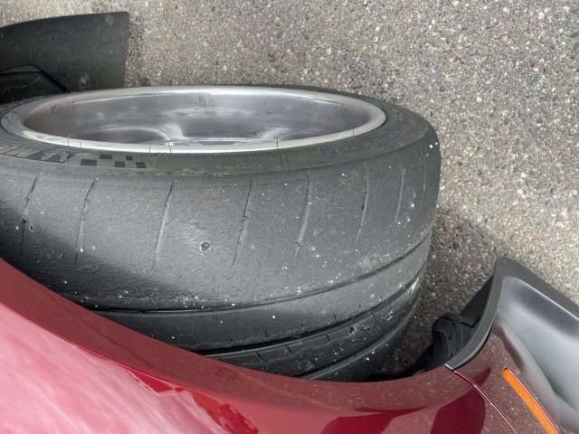

After some laps in my hands these new Cup 2 fronts look great! This says that front alignment is finally the road racers chit!!
Looks just about optimal for a heavy car with poor weight distribution.
