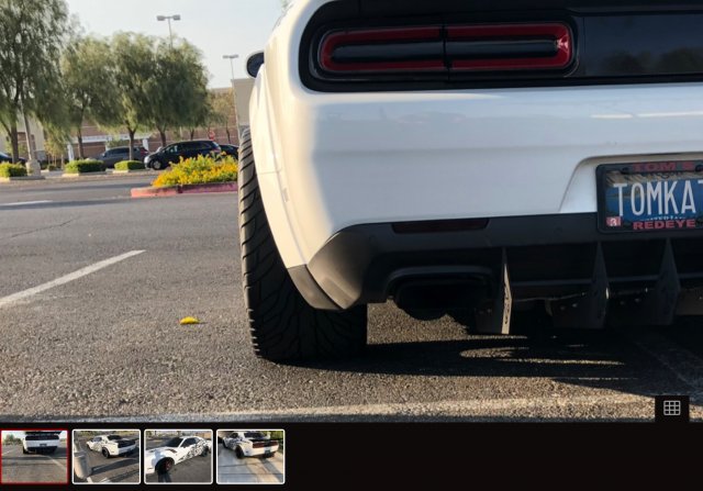

This is over the top IMO, but several are going ga-ga at the other place about 13.5” wide wheels! I love this Forum because we can say what we really think. It looks about like shit.
I think they are confusing their cars with these....
sad

Yeah. I think that’s pretty dumb looking.

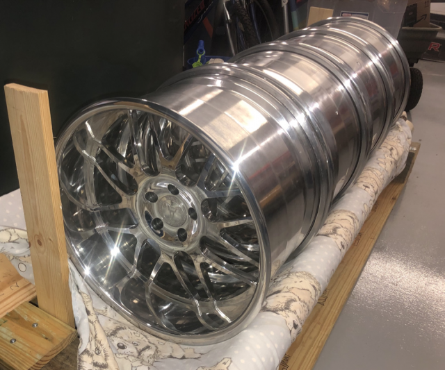

When I did the specs for the custom wheels on the Vette, used a plumb-bob to make dang sure I used up all the space and not a bit more.
Both of my 12” wide wheels, made by two different manufacturers are right on the edge. They are done well. The staggered set is right on the front edge, and Triumph’s 12” wide are on the money also. It looks to me 12” wide is easy, just add it to the outside of the OEM spec wheel. I don’t know where a guy can find and 1.5”! That is why it hangs out I guess.

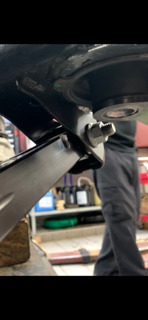

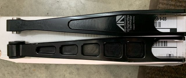

Tonight I needed to make sure these parts have not been covered YET. Got a example of something that DON’T WORK, and of course I show what works!
Saw some parts cheap a year ago at Thanksgiving and really did not understand the fundamental difference in a brand XXX Lower Trailing Arms and the real AAD Lower Trailing Arm. I installed the Brand XXX items prior to paying for my cradle removal and install of the other control arms from AAD (not including their Trailing Arms), last spring.
The good tech showed me the interference shown in this picture after removing my cradle and looking at things.
Why does it do that? I had the new AAD Arms to install for a while in my garage. What I hated was the eternal click caused by the interference. But, we have not driven it since October. Not to mention a bit of a squeak caused by the old time bushing that is really a garage project. Someone cuts pipe segments to put inside of the bushings, and call it good.
Today, while between putting in the new set (all arms on my car are AAD now), I compared the two.
What pisses a guy off a guy like me? When I called Brand XXX to ask why this happens last spring, I was told I must have tightened the connection too tight! Or that my new Redeye was indeed a stupid unicorn and had some real special cradle connections. Not that they knew their cross section was rotated 90 degrees wrong! That arm on the bottom has a connection neck that is flat TOO BIG AND WRONG.
Also those Spheriflex bushings -barely visible - are the shit! Smooth, quiet and precision machined. Just the way this set fit VS Brand XXX was more smooth.

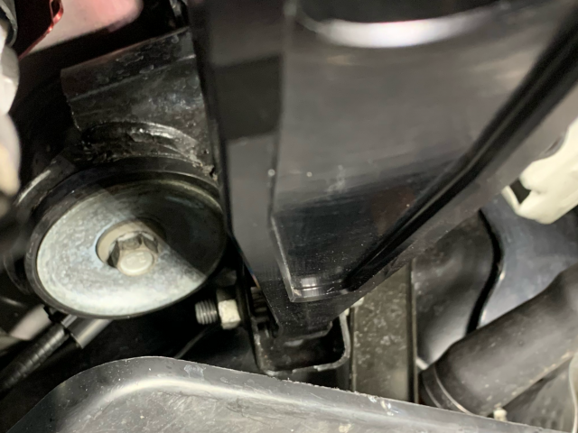

Picture of a AAD Arm installed and all the appropriate space around it.

I think it's been shown over and over again AAD is the best single purchase. Don't try something cheaper to save a few bucks.
