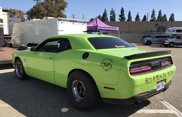

You don’t need to do any of this to run 8’s anymore. A stock HC engine properly tuned with e85 and the 3.0 on it will run 8.90. Did it just last week. 84B918F9-2CEC-4EC7-BC9D-2CE7E1147ECC.jpeg
ostmike
6 Second Best E/T
#1481
187
522
Portersville
2015 Hellcat
You don't need it to run 7's either. We did it several years ago with a stock Hellcat PCM and stock IHI 2.4 and a stock throttlebody. Obviously this wasn't in a factory weight/chassis Hellcat but wanted reiterate what Marc W. is saying - the stock PCM is pretty darn useful.
