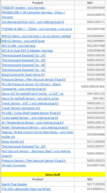

Here is the list of my complete FuelTech FT600 kit:
We bought the remade wiring harness and then built our own sensor harnesses. Some of the basic sensors are in the FuelTech wiring harnesses.

3,356
6,700
How many suspension travel sensors?
I imagine they want to see the front and rear, both sides?
