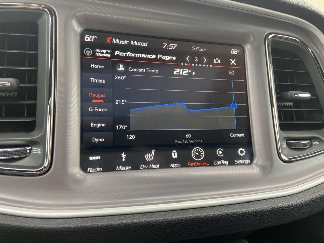

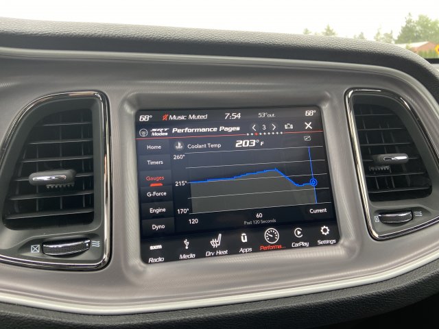

Okay, I'm too IT challenged to get this to post correctly!
But running hot at times that I am not running the car hard!

Those do not look unusual at all for the stock tstat.
