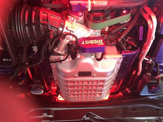

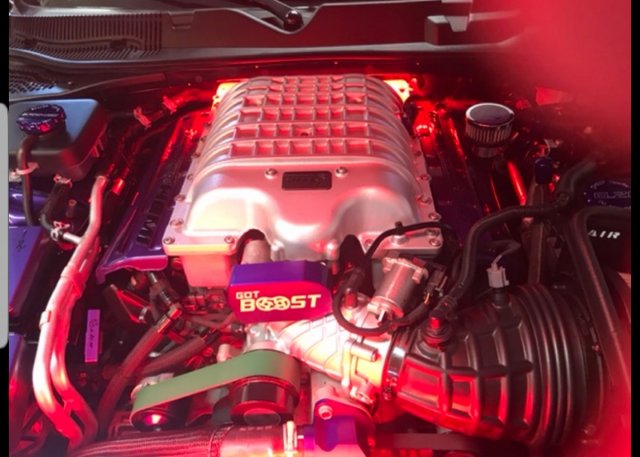

I put a 180 in stock Redeye with not issues. While at it I replaced the thermostat housing. 564EDFA2-37B5-4A5B-9FF1-12A6354C1A11.jpeg
