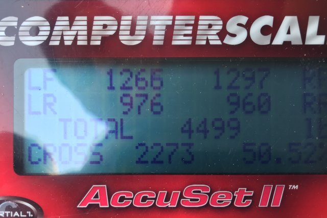

Is that weight with you in the car?
Yes. I scaled at 4499 With me in the car and added a 25 lb bag of ice in the box. 33172DAF-1905-4728-AFAD-78211A53D915.jpeg
