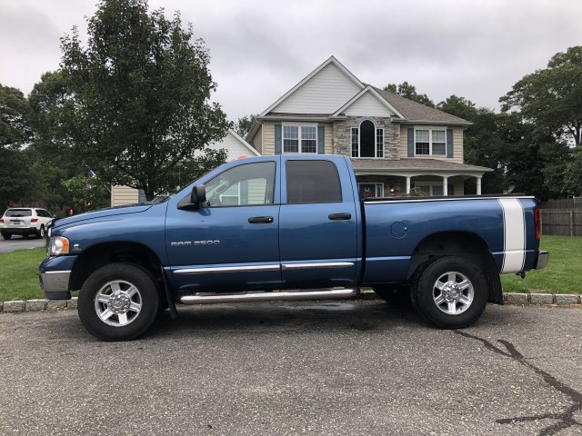

Does that include diesel powered trucks? I’d have to doubt it. Hopefully. Closest to the house sometimes its in the driveway, otherwise in the street. My CTD is almost 20 yo so whatever…

Oh fu**! Naturally I didn't read it and assumed gasoline. Meh, whatever… Ive got 266+k on my old gal, but whatever….
PS, is this admission admissible in court? Like I care…I was hoping to ride this truck into retirement, but whatever…Power Wagons are nice!
You're fine. It's the '19-up ones that have more than their fair share of issues, with CP4 pumps, transmission dipsticks, grid heater relays, etc.
Then again, you may want to disconnect the cable for the grid heater anyway, to avoid potentially having parts of the bolt at the heater element end up in the number six cylinder.

So far so good brother. Thanks. My girl is an 04.
