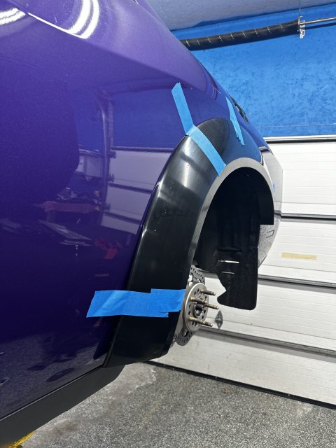

Got these off ebay . Fit great to have Glen make me custom wheels. Great 3m tape just like my GNX.
fits good. Remember not in place 100% IMG_8416.jpeg IMG_8419.jpeg IMG_8418.jpeg

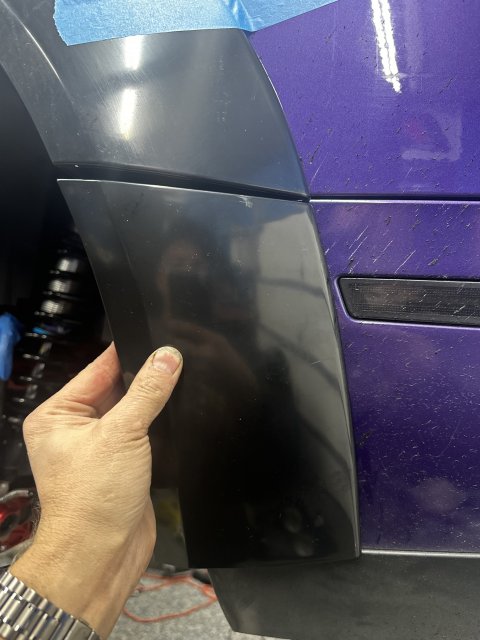

Of course the bottom piece fell off, too much rubber on the paint Won’t let it stick! All kidding aside they look like they fit well. Are you gong to paint match. Just flairs on the back will give it the 170 drag look.

Not cutting your fender wells at all?

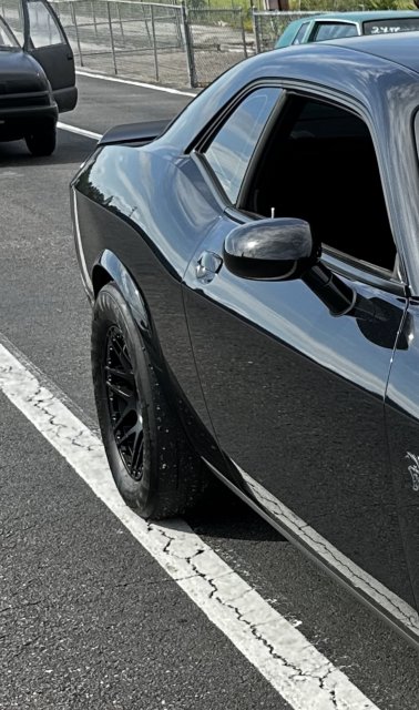

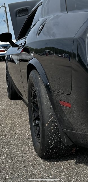

They’re starting to grow on me. These give you an extra 2.5”. I took the front ones off (you can see them in the 1 pic)

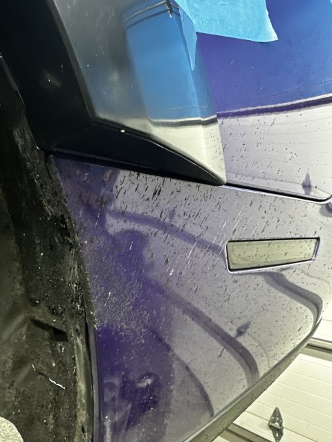

Make sure you put some PPF off Amazon under them close to the edgers, the wind/vibration will make them move and they’ll scuff the paint under. I got a 6x24x roll of 3m ppf off Amazon and cut cut it up and put it under mine. Mine attaches with 2 clips and magnets. Not crazy about the magnets but they don’t move at all. I might take the magnets out of them and go to tape, have a huge roll of heavy duty 3m

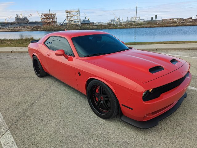

N
Never Noticed the subtle stripes on your car, look nice
I had it custom made a couple years ago. Depending on light conditions it’s more or less visible.
