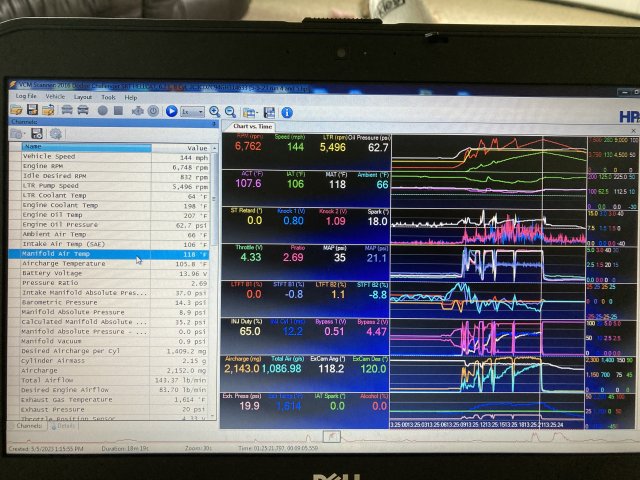

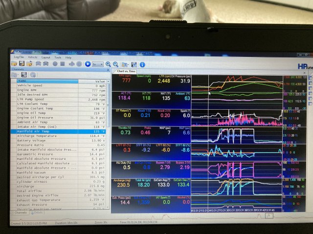

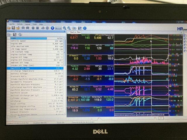

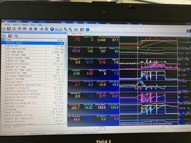

I just emailed you a log from @vortecd car 3.0 upper stock lower. Was in the 70s day of the log
holy shit that iat stayed below timing pull even with a 118* start. Thinking of getting rid of my ihi now. 3.0 + ic chiller would be nuts…

They do better than the ihi as far as temps. He has the whipple intake as well.

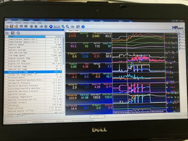

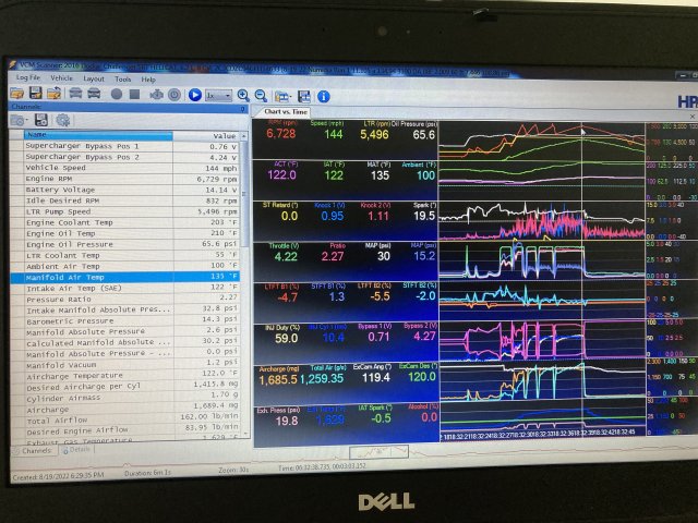

sent him mine with the whipple in the heat at Rockingham with little to no chiller time before the pass. still never went over 111.

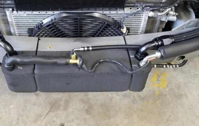

I am not running a whipple but i AM running an IC Chiller and Bumper mounted Res installed by Allpar Garage this season.
IAT's are no longer an issue and it's nice. last year even with the BMR box it got TOASTY.
We'll see how good it does when we drop to the 2.50 next time out.
