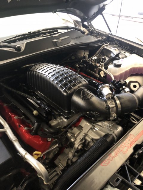

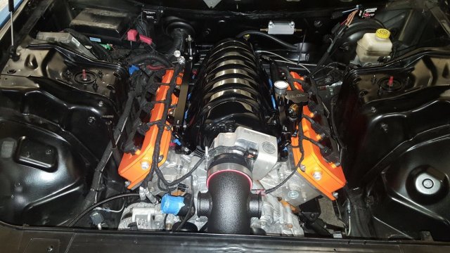

Late to the party. I’m running Jake Sampson’s 428ci with a 4.2L KB.
Jake is small time but he is very meticulous and builds one heck of an engine. Communication and working with him was top notch. Call, text or messaging, he was always responsive.
My engine is way over built for how I’m using it but that was the intent.
As far as the KB it’s been a great but it absolutely needs additional cooling (chiller or ice tank) to manage IAT’s. We were seeing as high as 200* on a pull to 150mph. I have a FI interchiller waiting to go in for next season.
If I were building a car now, I would be waiting to see what the new Whipple 3.8 has to offer before I pulled the trigger on anything.
Here is an article on Jake during my build if you’re interested:
https://www.enginebuildermag.com/2019/09/eotw-428-cid-gen-iii-hemi-hellcat-engine/
891836B2-91E9-4727-B2A3-F6B2420F19A3.jpeg 1EB9DA74-509C-4170-8045-9392984971E9.jpeg
Taxinator
#1447
289
565
SANTA CLARITA
2017 Charger SRT
View attachment 33853 View attachment 33854
Beautiful build!
Looks great. Jake and I are chatting for the last couple of weeks. Let's see where his pricing and delivery timeline are.
But I do agree, he focuses on details and wants to build the best engine possible.

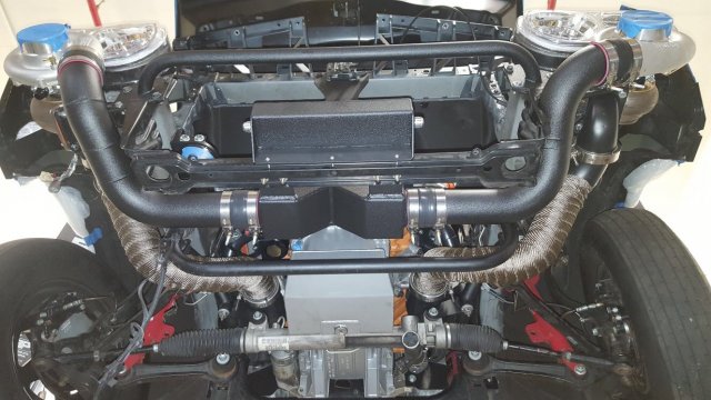

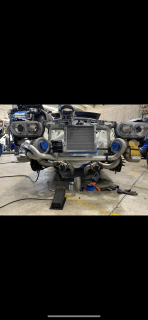

WhipCat
#985
1,500
3,871
In the Jungle

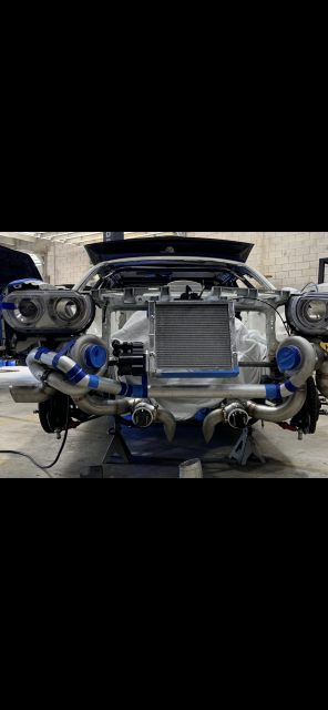

Stop pussy footing around, if you wanna go real fast, do the right thing.
34E4A211-A492-4583-94B4-69A9A046AA2B.jpeg E5BCB5D5-6956-4FBC-9EB3-457658F0E5F7.jpeg 614CD01E-B8BE-4506-BA32-2A08558BD3AA.jpeg 87E3B0F0-F827-48B9-A653-3E4EA591D8F6.jpeg B8D35321-5684-4290-9354-CB58C17D9FE0.jpeg 36A78B6A-2EA6-4F9A-BF77-9F60A6044C35.png

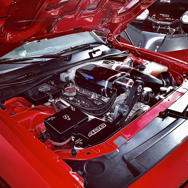

I second 426 with KB.
