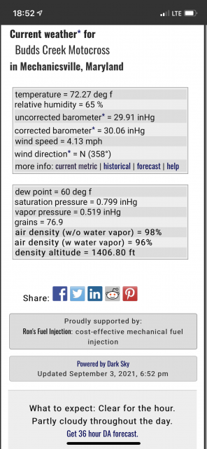

The 9.84 I ran was in 2000+ DA. I expect to need to slow the car down at CF and Moparty to hit the 10.0 class I plan to race in.

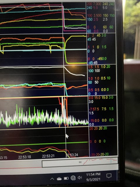

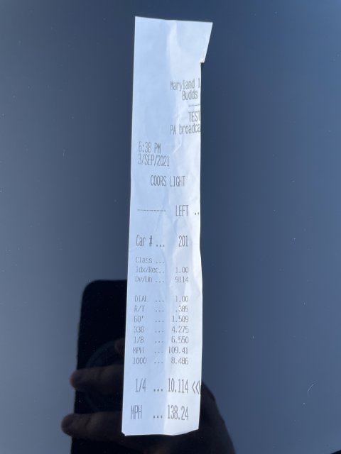

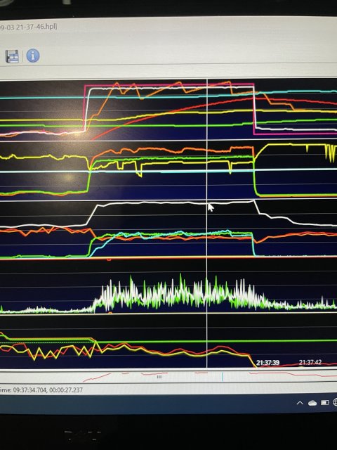

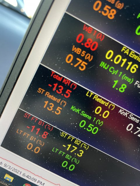

Im out. Im so angry right now. There is no rhyme or reason as to why it pulled timing. Fuck this car.
1BC2A9CF-5793-4F8C-8D97-E3345625CB12.jpeg F3101644-BEDA-4085-A438-323A20FEF480.png 73AF045D-4A3C-4E7E-9AFA-834B5E36B34F.jpeg

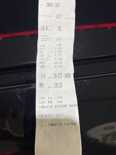

Just did it again. Not wasting any more time or gas and going home. Very disappointed right now.
7,473
19,638

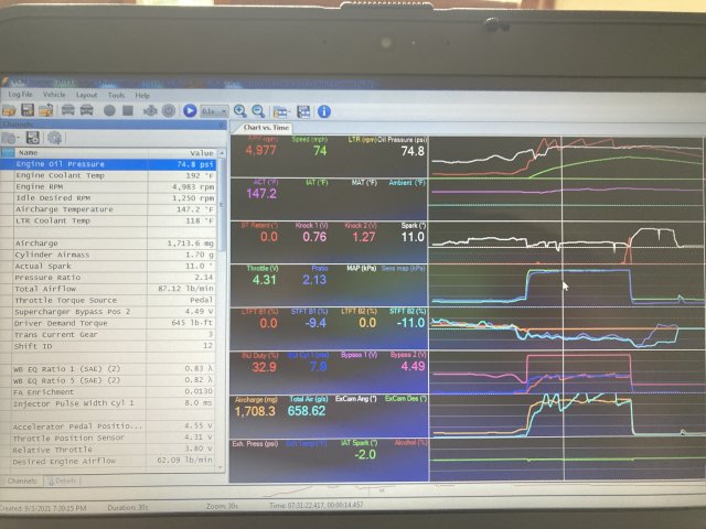

It ran 138MPH pulling 13.5 deg? Send me your log if you want me to take a peek.
4,116
10,335
Thread Starter #112

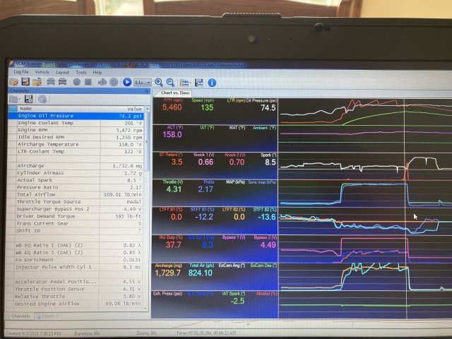

Attached, I went back a revision something is not right.
7,473
19,638
Check for anything that could bang anywhere. I sent you a PM but I also saw that exact scenario when my flex plate inspection cover got loose on the bell housing.

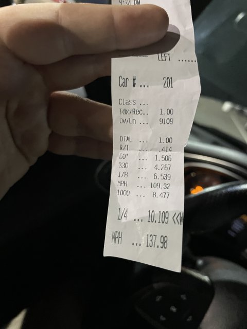

Reverted the tune and went faster. No knock at all. Wrote a mini tune. Took half of the difference in spark between revisions OST gave me and added it to the last revision. Will see how it goes…

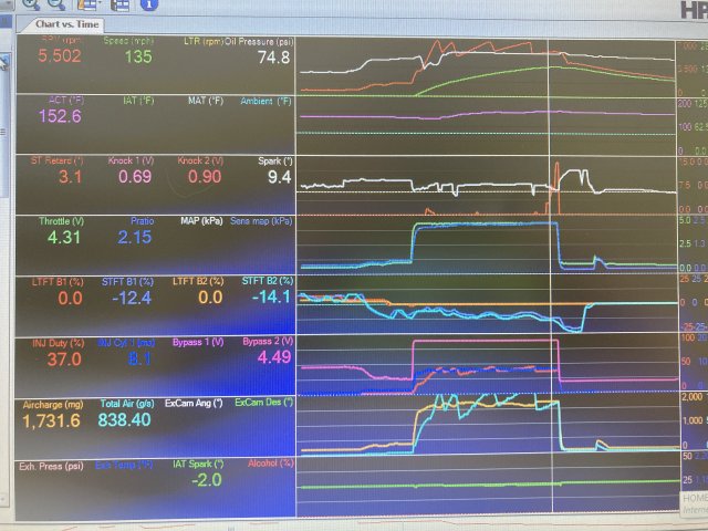

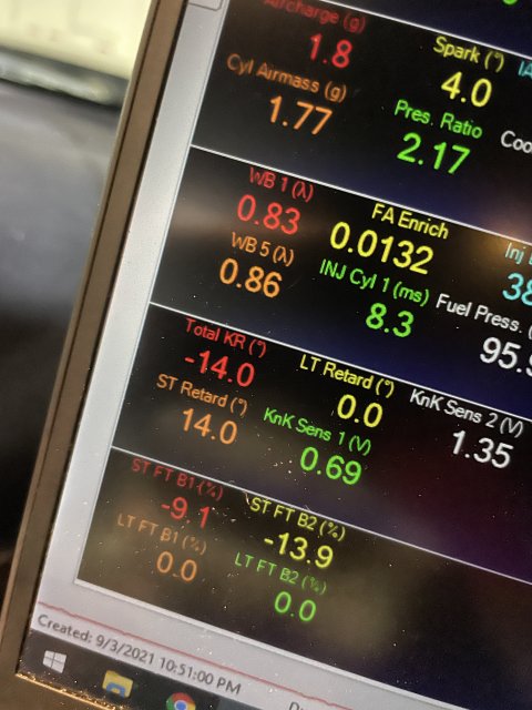

Even with only a smidge of timing added it didn’t like it. Trapped 139 and no 9 still. Really disappointed.
267DCA7B-A43A-4E7C-9862-40940C3E3767.jpeg F9FDA940-2FB2-475D-BBD1-5263080B485A.jpeg 68DE4520-0038-4E69-AED1-2444E48376A0.jpeg

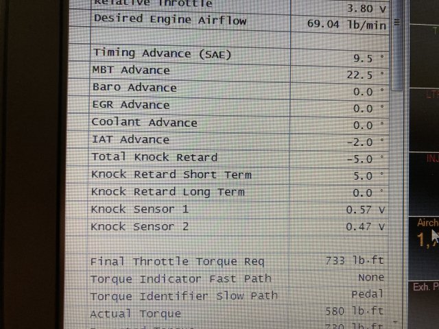

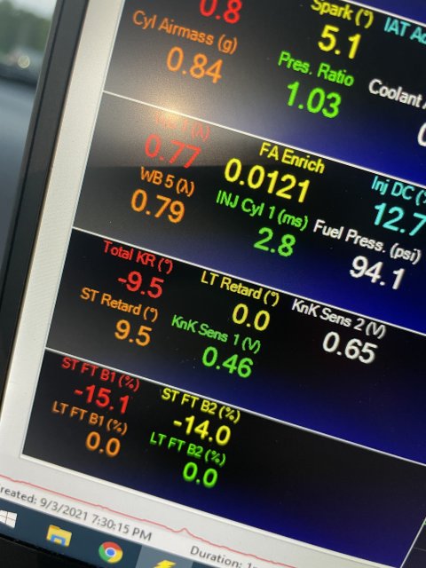

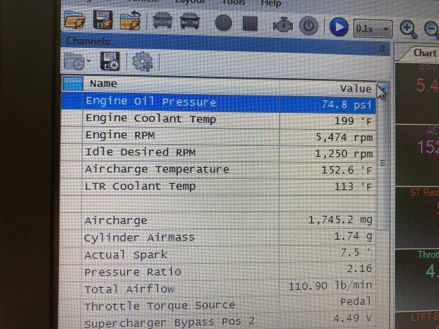

Quick look at you 1 st log, Your IAT is killing you!! Your run was going great until the last 5 mph, you were almost at the light when all the timing was pulled, that probably didn’t kill your 9 second pass. You have 2 degrees taken out for hot IAT most of the run, timing started to be pulled for hot IAT right after your first shift. IAT’s in the 150’s when it said enough, it probably was real detonation, be glad the tune saved you. Get that IAT under control and I think you’ll be golden.
3,764
8,921
Second pass you were hot from the start, IAT’s in the 150’s before you got out of third gear and pulling 2 degrees of timing right at the start of 3rd gear. You had no knock at all for 95% of the pass, the tune looks solid from the log, keep that hood open as long as you can, have someone close it for you right before you got out to do your burn out, get a power chiller of some sort!! image.jpg image.jpg
