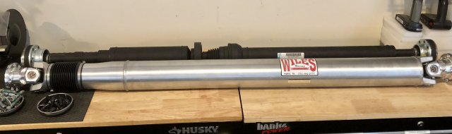

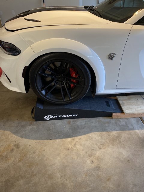

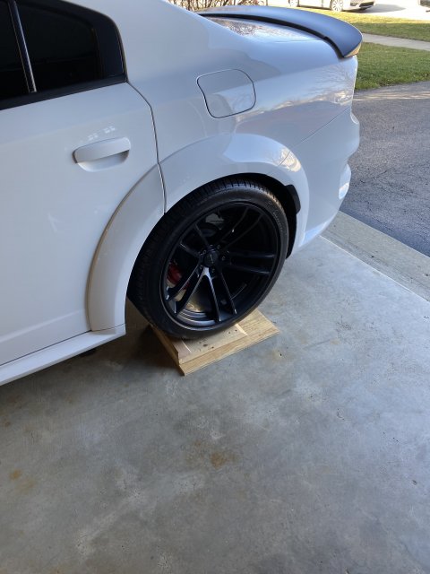

Just pulled out my factory ds and planned on installing the Wiles that arrived today. Just a bit beat from hanging all the Christmas lights as well this am so tomorrow I’ll begin the install. I am fully prepared to be disappointed that there will be interference with the Barton shifter and will take it from there. Hope everyone had a good Thanksgiving...

Drive shaft in. All good! I had to pull it out two or three times to fit it but we’re all good. Got it only up to about 85 but no vibrations. You could see on the weld exactly where it was hitting the shifter and it left a mark on the shifter as well. I just hit those areas (on the shifter, didn’t touch the ds) with a grinding wheel for a while. Took off enough material to clear it, and when I took the driveshaft out for the last time in order to put Loctite on the bolts I hit it one more time. Only problem I couldn’t properly torque them down as I couldn’t get a torque wrench in so I just tightened them up nice and firm. 👍. Not a tough job at all, just a little tedious but if you guys don’t have an issue with interference between the Barton and the d/s, it’s a bunt. R&R the exhaust is cumbersome with one person but dooable. Two people would be a big help. Thanks to @Speedy! as I usually check his yt page before doing a mod that I don’t feel like bumbling my way through. 🍻

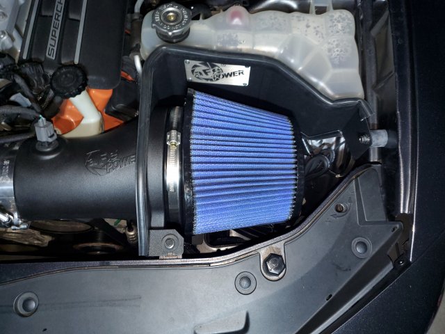

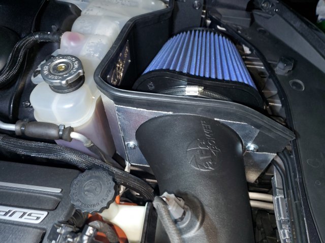

Swapped my LMI intake to the aFe and added heat insulator. Well, more like yesterday lol.

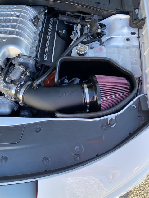

Actually done last week but didn't get a chance to post it. Shout out to my buddy @greasy for doing the work. Don't know if he's on this forum too. But no more space and she whines!!!! Lowered on H&R Springs and JLT CAI.
