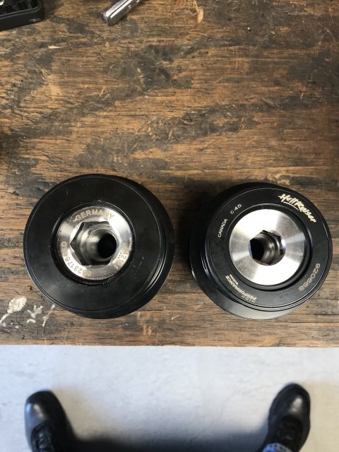

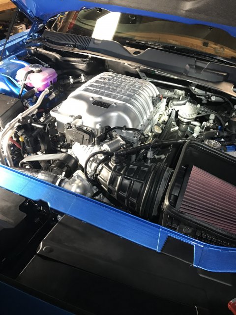

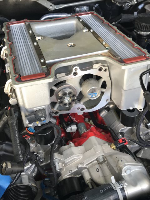

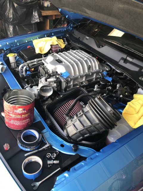

INSTALLED HELLRAISER PULLEY.
Got a great deal on a brand new unused Hellraiser pulley ($450). All I had to buy at extra cost was the belt ($70) and the smaller than stock H17 size hex install tool for the Litens pulley ($7). The supporting Metco install/removal tool and large Hex tool to remove stock pulley are needed at extra cost regardless if you buy the full kit for $850 or not. Haven't driven it yet. Finished up last night. Car started with no difference at all, and ran to full temp up and down in the RPM range without a hint of it even being on there. Amazing the compensation these computers can do.
May WIKI the install later if I have time. There are some small physical differences between a standard Hellcat blower and the RE.

Nice work Cool. Look forward to the Wiki. What sized pulley, and will you have it tuned?

Thanks. It's the 3.17 (#920668) No tune yet. Supposedly It's good for 45RWHP on a RE with no tune and as long as you run 93 octain your fine. Weather's getting cooler also:D. I'm going to run some Octanium boost if I can get my hands on some for now. The car will eventually be tuned, but I have some other ideas on things I might do, so the tune will wait till I'm done.
