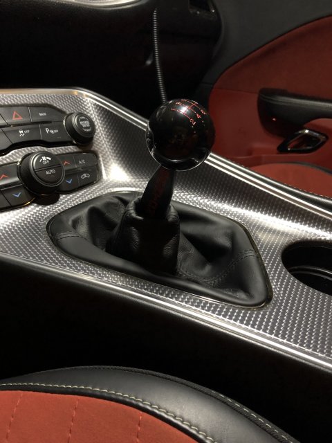

This actually a good thing. You have the much more uncommon Barton that uses the original shifter base. Most buy the linkage with the Barton shifter and it works only with the Barton shifter. So your stuck with that whether you like it or not. This gives you a lot more options. Any handle style that works with stock shifter will work with it and you have the Barton guts and precision. You could go stock shifter for stealth or originality (which is what I did for a while) or swap for custom. I have a super rare out of production factory pistol grip (NOT the bent one that looks like the early 70's and doesn't fit your shifting position correctly) with carbon fiber handle or black handle depending on what I want with original looking shifter pattern font on top. I then custom fit this universal Hurst shifter and custom made ball to match my Hurst rims, which is on the car now.
This is on my '09 SRT8 not my RE.
That looks beautiful! Thanks for the info, yeah I gotta change from the stock handle. Its starting to show some wear

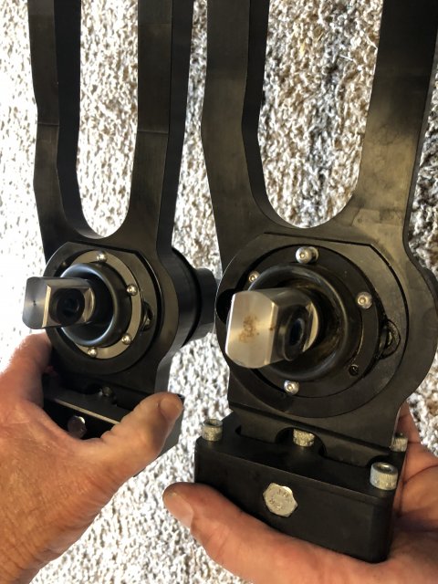

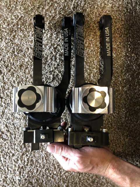

So I'm about to send back this beautiful new Barton shifter, but before I do, are there any improvements from the old type to the new type? Sometimes I get quite a notchy 1-2 shift and was wondering if this was normal for all Barton models?

They are at least on Version 2
It says it right on the support legs.
They've improved the geometry of the shifter.

Is yours notchy?
17,156
53,772
Maybe?
I have an original
As opposed to "notchy", I would call it either finicky or precise, but neither intended to communicate troublesome.

:unsure: Maybe I should keep the new one
Can you post up a picture of the support leg graphics?
And then also compare it to what you've got?

Yeah now I’m leaning on keeping it. If so, I’ll start a new thread to compare them
2,313
5,535
Was gonna start a new thread, but there is nothing to compare. They feel almost identical on my only road test so far. If anything the third rev might feel a tad better than the original. So I’m going to sell my old one on here soon for a good price. You can see where a few of those tiny Allen heads backed out of the bottom. Had fun time installing if nothing else

BTW, I'm feeling left out, despite the fact that I was directly helping the guys at Barton with the initial development, I'm at least 3 or 4 revisions behind... (unlabeled, R1.1, R1.2 and now just "Barton" on the legs)
If you haven't already seen it, check out my Barton Mod page.
Barton Spring force Mod

It does say Rev3 real small on the leg
