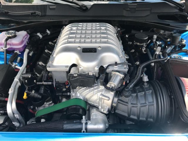

RE-TORQUED ALL BLOWER BOLTS.

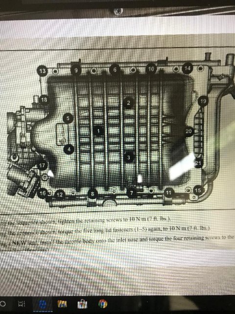

My cars got 1051 miles on it, that's it. All I can say is I re-torqued all 31 bolts (21 T-30 torx heads and 10 10MM hex heads). Except the top 5 bolts (the long T30 bolts) at the very top of the blower....ALL MOVED. The smaller T30 torx moved about 1/16 to 3/16 of an inch. The larger 10MM main bolts moved a 3/4 turn or more! The T-30's get torqued to 7ft l.bs, the 10MM hex bolts get torqued 22ft l.bs. It's really not that big a deal to do it. The factory tower strut that runs under the plastic windshield wiper cover needs to be removed to access the rear bolts, but it's 4 bolts a few push pins and some wire harness clips, a windshield washer motor grommet and it's out. I was shocked at how much the bolt's moved honestly. I have read and seen posts of guys who have said they experienced blow-by (@Paladin06 being one I believe) with factory blowers and gaskets. Maybe this is the reason. All I can say is two things: Look into it, and do it.
Blow by occurs when the OEM intake/sc gasket fails, at the oil galley port. This particular part of the gasket is unsupported by the gaskets metal structure, and is only a thin membrane that breaks down under psi, heat and oil.
This has been an issue, with this design, since 2006, at the inception of the 6.1 engine.
Right now, the permanent fix is either the blower spacer kit, or the Thermalnator gasket set. In other words, to get rid of a poorly designed component, or plan on replacing it, in the future.
Bob
I'll check mine this weekend and report back. Thanks for the headsup!

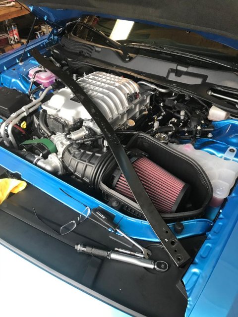

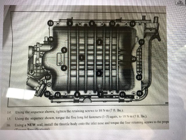

Here's some pics and some specs from "that other site". You should have a small inch pounds/ newton meter 1/4" drive torque wrench for the 7ft. lb. torx head bolts to be more accurate, and a 3/8" drive for the 22ft. lb. bolts. Basically you do all small T30 torx heads first to 7 l.bs, in sequence,(on top of the blower and around the perimeter 21X) then go up and down the sides, in sequence, for the 10 main bolts to 22 l.bs. (10X).
P.S. Your going to be swapping long and short sockets of the same size to get to the rear bolts. This all is easier than it may look.
Damn! Glad they just bolted on a new one for me last month!

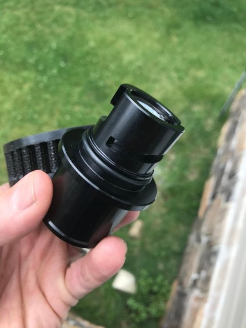

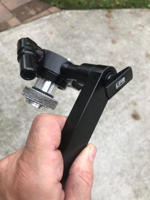

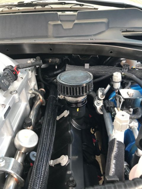

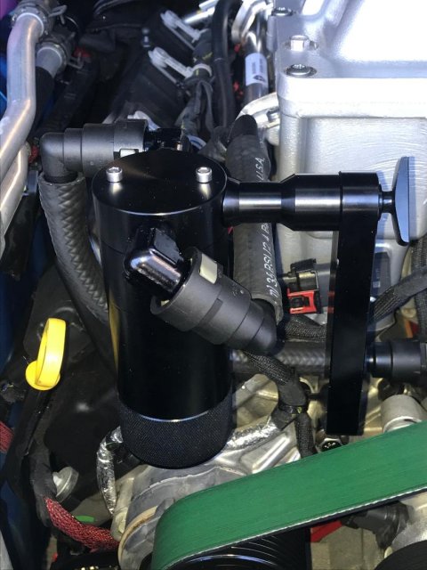

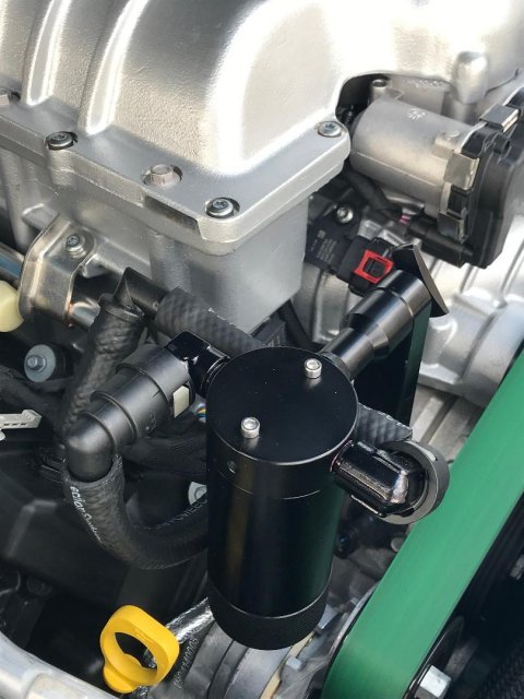

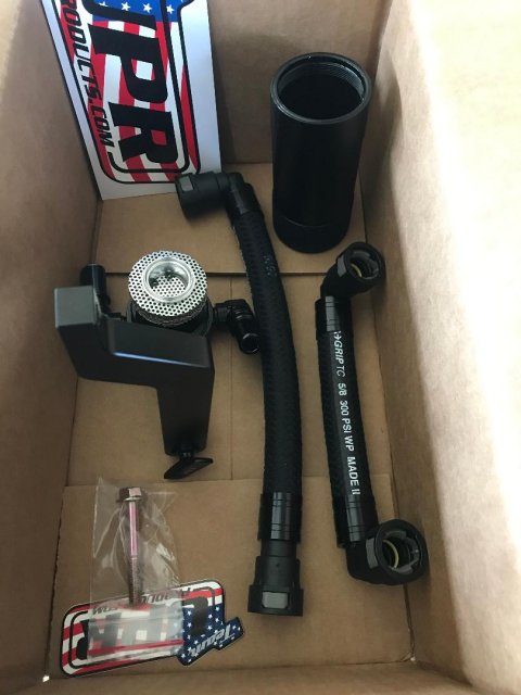

Put on a catch can and breather. YAWWWWN, I know. But wait.... there's more. Lol. First, I will say the UPR is more money but it is quality all the way and extremely well made. And I'm not easy to impress. BUT, it's not all rosy. Lines did not fit to my liking, were too bulky, and WAY overkill, so I used 1/2" fuel line and cut to EXACT length and raised the valve cover side with a 1/2" elbow to be perfectly square and level with fitting so now all quick disconnects disconnect with one two finger squeeze and pull..no binding.
ALSO, I could never figure out how guys were running "breathers" and not screwing up the PCV flow path. I kept saying "It's gonna pull atmosphere air from the breather not the crankcase". Then I went to UPR's website and saw it's really a BLOWOFF valve with a one way check ball. That's when I said "Ohhh" then..."Dohhh!" Also, super high quality piece.
