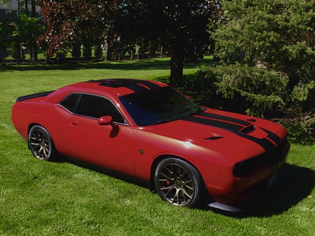

Went for a drive and took a few pics....then cleaned the bugs off. A52268FF-D0A1-4B89-9723-88C939FC76A8.jpeg

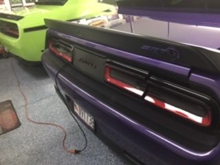

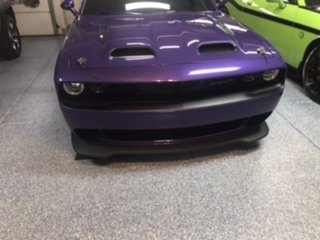

Ok, tell me if you see the latest mod for the Redeye.
478C5619-A755-4AAC-A2FB-DC45945332CB.jpeg 7103B039-D9F8-41F8-9314-EE17CF7AFA29.jpeg

Trunk that doesn't close correctly?

Battery tender cord? Thus not closing trunk?

EV conversion?

Good try guys. I blacked out the top side of the front and rear bumpers.

Thanks for posting this up. Gonna have to look into these. I haven’t called the guy yet. Can any of You who got these post the price?
4,871
25,928
Your Order
2015 - Up Merrick Motorsports Dodge Challenger Bumper Blackout Decals Front and Rear Kit
1 × $94.95
Total $103.90

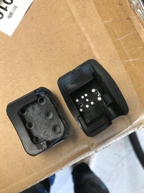

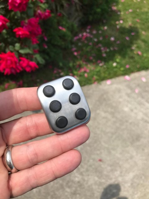

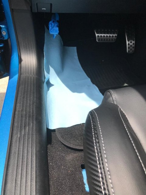

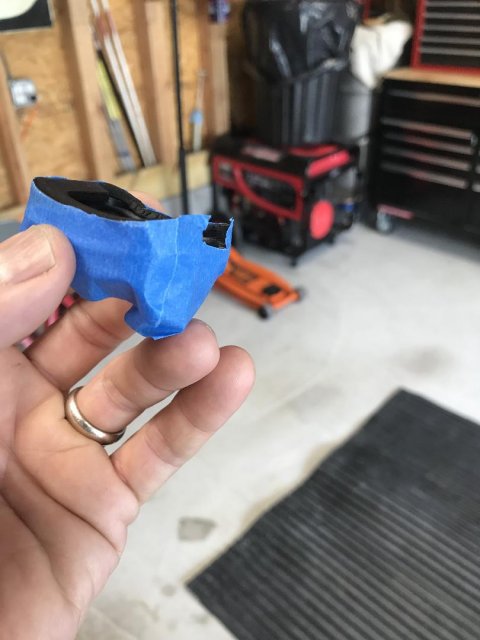

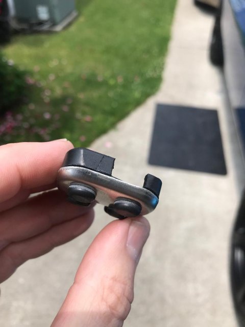

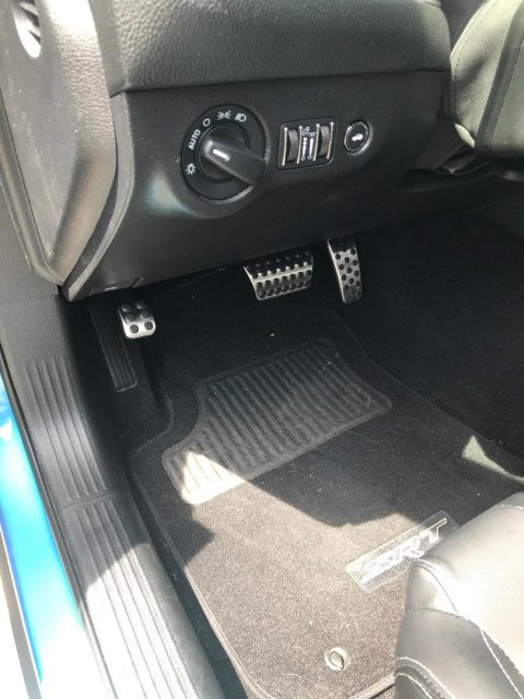

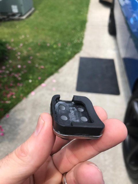

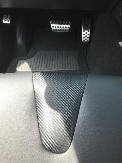

MATCHED E-BRAKE TO GAS AND BRAKE PEDAL:
I put on an AMG (# 2034300084 For Mercedes) E-brake pedal cover. Yes, I'm a little OCD and it bothered me every time I opened the door and got in that the E-brake didn't match the other pedals. LOL. Let me say right off, it's NOT a direct fit, it has to be modified and "glued" but if you have the patience and do it right, it works out real well and looks great IMHO. I trimmed the pad with a razor knife, Dremel tool, and small sharp electric wire cutters and matched it to the convoluted underside of the O.E pad. I then cleaned it of all release agent thoroughly with rubbing alcohol. I then cleaned the E-brake itself with rubbing alcohol. I then masked and trimmed the pad and all surrounding areas with masking tape and applied the 'Right Stuff' to both. I then put together and filled all voids underneath with more Right Stuff.
TIP: Work quickly, and don't spare the materials. Meaning use nitrile gloves and shop towels generously. Wipe excess, throw away glove. Re-glove. Wipe excess, throw away shop towel. Repeat. Repeat. Repeat. Let set up an hour or two, hold firmly in place and gently remove masking tape. You could let it setup overnight also. Once it's cured and vulcanized it ain't going nowhere.

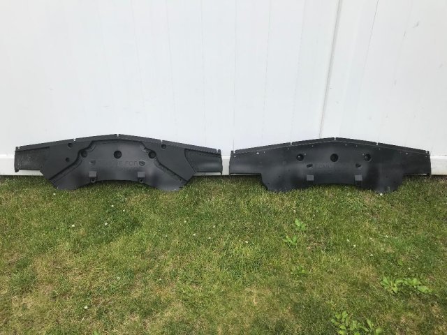

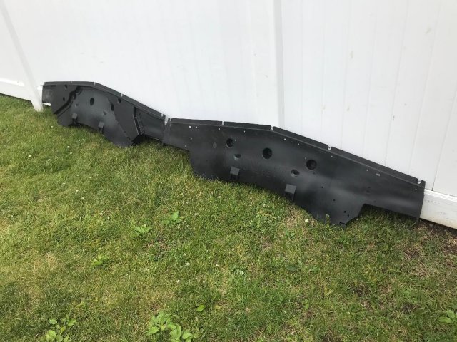

Replaced my RE engine splash shield. I was never a big believer in the RE brake cooling duct system so I bought a standard, smooth Hellcat splash shield (68184165AE) and installed today. Now I have less weight and drag under the car, and she's smooth. LOL. I'm not getting rid of the original ( 68404932AC) because it came with the car and they ain't cheap! @$340! so I'll just keep it in storage. And if @BULL ever proves they do something I'll put it back on.:p

I was interested in doing the same thing. I do not track my car. I drag race, so I have no need for those cooling ducts. Plus my 16 Hellcat did not have them, and I had zero issues with those brakes. But I was uncertain as to exactly which shield PN to buy and there was the expense however small. Well, I hate returning shit. So With the uncertainty......
I ended up drilling out 21 plastic rivits. Dam plastic shavings everywhere.

I just left the splash shield and belly pan off after the last oil change. Think I am just going to run that way for a while

Will absolutely hurt nothing. Cars were running wide open underneath since forever. But I will say every time I crawl under the car to change oil, they have dirt and muck, plus road rocks all up and in them.(I'm actually surprised at how much sometimes because I'm pretty much a fair weather driver and I don't go 4- wheeling with it). Now all that crap will be up in the engine compartment. Plus, when your doing 200mph, there will be a little more turbulence under the car.:LOL:

On my 16 Hellcat I notice the same thing with small rocks and dirt caught by the belly pan. Easier oil changes and a dirty engine bay... no such thing as a free lunch I guess. As far as under-hood turbulence, I guess I am more concerned about losing the brake ducts...worried about brake fade during those 25mph panic stops..:eek:
