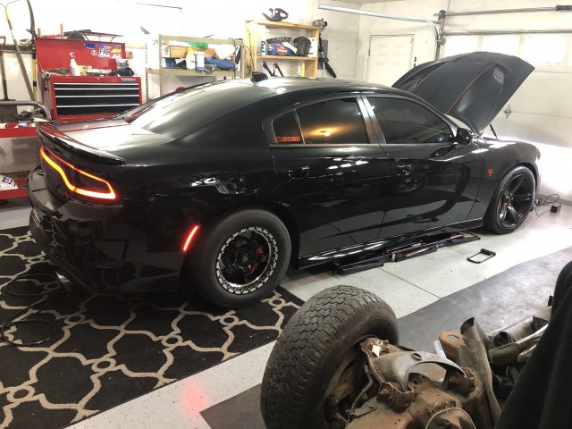

Got my LED sidemarkers on, shortened endlinks and bmr trailing arms. Got my radials on and tazer on with buttons for line lock, cooldown, and custom drive mode short cut.

After the mods were installed I drove home on OE 11" wide wheels w/ 305/35 R888R square set up. It felt killer! They got a test on an exit ramp or two, I was fairly impressed at the lack of lean and precise feel of the steering wheel. I drove maybe five miles on the track set, with the good brakes but it is too cold for the Cup 2's to have fun. Did it Friday, it was a little warmer, but still not good.
Now this week with 60's expected with the set on the floor, there may be a couple of roundabouts that are going to see some action. Also I bet I may make an assessment of the lack of wheel hop or not;) I also have a hot tank of gas with additive I was going to use. I am going to have some fun on my "essential" trips, weather permitting, screw it!
I’m going with it being essential to road test the essentials on your REWB on essential trips to an essential job!

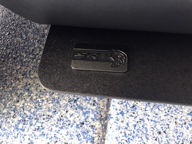

Add a Redeye SC badge to the side skirts. 7F894375-B620-4AB8-971D-8C94B5C54FE9.jpeg

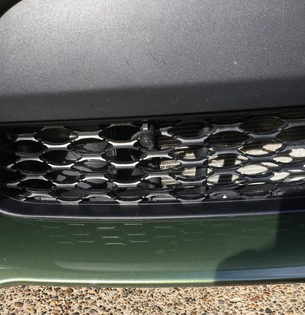

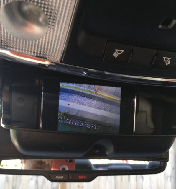

Front camera install. Bullet camera in lower grille. Monitor in the overhead console flip-down sunglass case. Wireless with the camera transmitter under the hood to the monitor receiver tucked up behind the overhead console. Plus: Better than the non-existent factory camera option. Minus: Camera is not a true “fisheye” lens, only 170 degree field of view, so camera has to be pointed off to the side to catch both the centerline of the splitter and the part in front of the passenger side tire (for angled parking), which makes the view a bit awkward until you are used to it.
You didn't want to hook that up to the radio???
PJO
#1380
47
72
Louisville
KY
2019 Charger Hellcat
I did/would, but, at least what I was able to read up on, solutions to enable a signal to show up on it (as the back up camera does) were pretty cumbersome, with many descriptions of people just giving up, since the Uconnect is locked down pretty well. But, if someone were willing to post a simple, proven, tutorial I could follow......:)

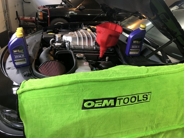

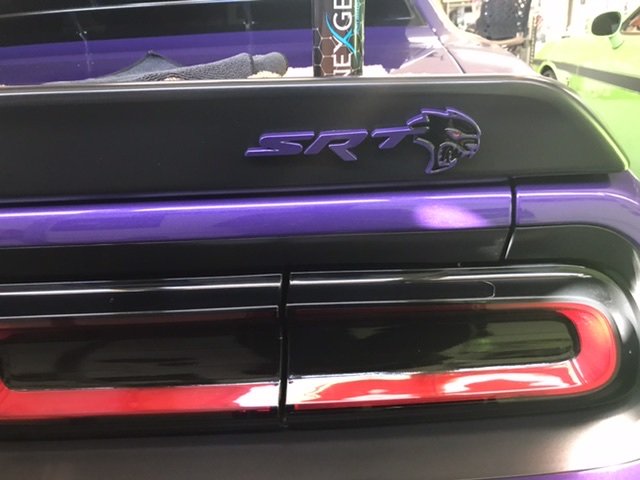

Made the switch to the purple stuff. HPS Royal Purple. Have heard it does well in e85 applications.
