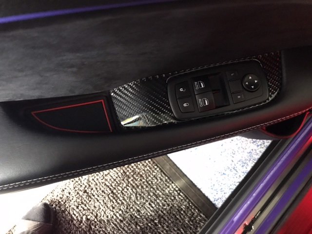

Dressed up the window control D2C08847-9DFB-471D-AF4C-B8460DA66559.jpeg CB854445-3E16-49A3-8518-057DC84319B7.jpeg panel trays.

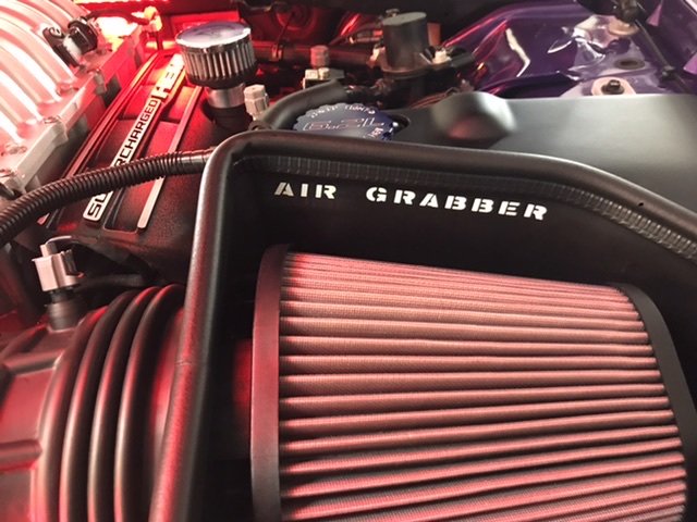

Added the 1971 Plymouth GTX Air Grabber decal.

Dressed up the window control View attachment 8678 View attachment 8679 panel trays.
Sure wish there was a smooth bore throttle body tube that was plug and play for the 19 CAI.
I have a feeling that would help the SC sound resonate more.
But what you have been doing to your Challenger is awesome!
