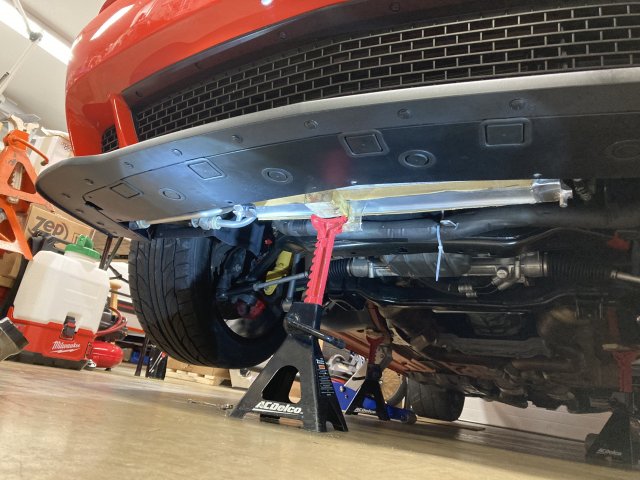

If you really want to get maximum efficiency out of the install get some of this foam backer rod from McMaster and seal the gaps between radiator to intercooler and intercooler to condenser so the fan pulls air through the whole stack not from leaks between them. Position the original upper and lower rubber radiator caps over one groove on the new radiator seal the gap between the stack and the upper and lower radiator mounts so all the air caught in the front air dam has to go through all the coolers not around them. Cover with 1 1/2” wide Scoth Super 88 Electrical tape for that factory look and seal.
View attachment 51537 View attachment 51538 View attachment 51539 View attachment 51540 View attachment 51541
How did you seal the sides and bottom?

Same stuff all the way around, one long piece between each radiator to intercooler and the intercooler to condenser. Started at top passenger side corner, long enough tail to go down to corner where original drain cock was then across the top, down driver side, across bottom and the ends met and tucked in under the mount right above the drain cock. It too the use of extra long needle nose pliers and took about as long as installing the radiator did but it does help to get maximum pull and airflow from the tractor fan through all the coolers.

So I assume you gained access from under the car? Just getting details so we can start replacement next week.

Yes, all done from under the car with just the front end lifted, including getting old radiator out and new one in.
Jack stand up front is just holding the radiators up in place not supporting the car!!

Perfect. Thanks.
