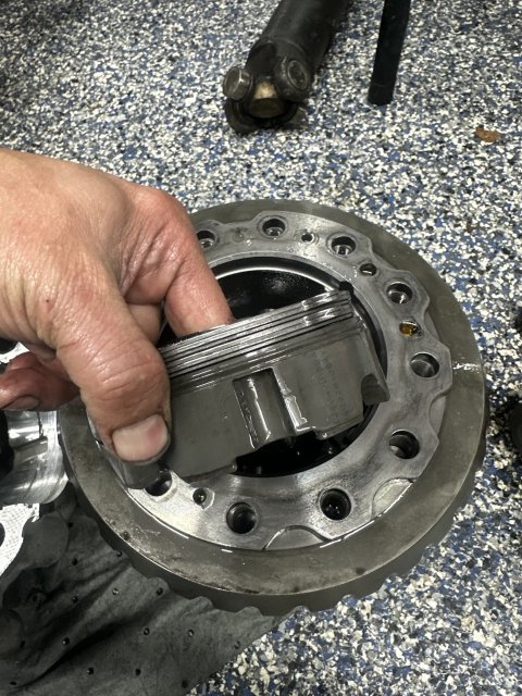

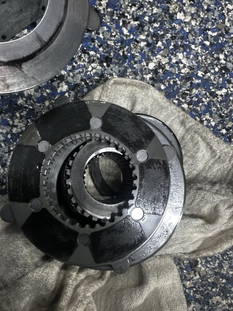

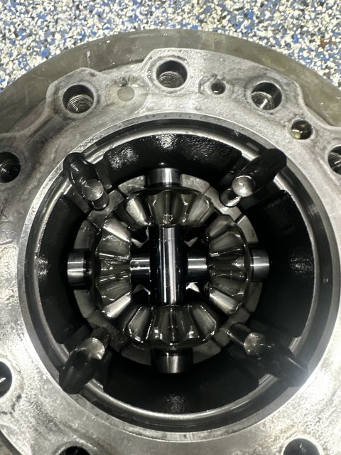

anyone here use the wavetrac an what has been your experience or opinion.
past weekend at the track car was wanting too do the one wheel peel a lot an broke left axle:(
70415475331__4F3682E0-E182-42F0-8785-59B41E44D0FC.jpeg 70415474350__A4EEBABD-16D5-4686-95E5-DE4E74BB7236.jpeg 70415476890__05684356-D9DE-4802-9C22-05BC911D4B00.jpeg

Just ordered my wavetrac thanks to speaking with @Hatermkr (also thats my diff he setup in the pics)
