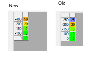

Cutoff, DFCO -> Misc Cutoff -> Torque Reduction
This one has me scratching my head...

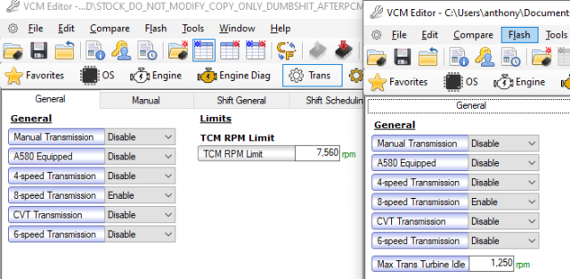

Now to discuss Transmission, this is where things get weird for me, in my pcm read prior to the flash the only thing that shows up in the Transmission section is General, Manual and Torque Management. I don't know if there is a bug in 4.4 but in the beta 4.7 new tables have popped up for me, these are: Shift General, Shift Scheduling, Shift Pressures, Shift Timing, Torque Converter. This may be a unique thing to me or a bug. This is beta software so I cannot tell at this point.
Transmission -> General
New to me: [TCM] 5722 - TCM Limp RPM Limit: If the engine RPM exceeds this TCM RPM Limit, Limp mode will activate and a DTC may set.
New is on the left, old is on the right, one option is missing, and a new one has appeared...

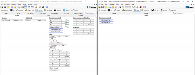

Transmission -> Torque Converter
All new in the comparison, may be a bug. If you would like these values if they are indeed new, please let me know and I can post them.
Transmission -> Torque Management
