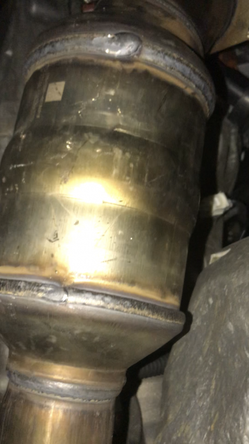

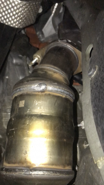

Took mine in today and it seems like my dealership didn’t replace them. Wtf.

I’m not sure if new catalytic converters look that way out the box. My hellcat is only at 16k miles so most bolts and parts still look fairly new. I will give them a call tomorrow and verify.

I'm no CSI, but if you look at the details - the scratches, the welds - like the scratch running diagonally through that square highlight, it is clear these are the same cats in both pictures.
That was my thought/observations as well - what are the odds of both the old & new cats having that exact same scratch !
4,112
10,324
None you got got. My cats were shiny as hell and had a sticker on them with your part number. Someone sold your cats probably. Look for a sale in your area.
Yes, it is two photos of the same cat.
