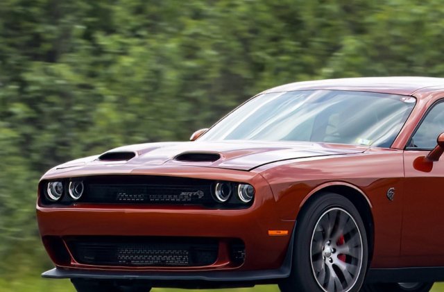

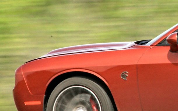

I was organizing photos today for HCOTM (your vote would be greatly appreciated!) and I noticed something new. In the first photo, it looks like the L&R edges of the hood are high, I first thought it was the angle of the view. But the second photo confirms it, sure looks like the edges of the hood are pulling up at speed. It seems to be held down fine by the latch in the center but the hood looks like it is flexing and pulling up at the sides. If any of you guys have any thoughts, warnings, suggestions, I’d like to hear them, thanks.
View attachment 112465 View attachment 112466
I can tell you it's definitely not unique to yours, mine was at least that bad.
Somewhere in ancient history I have a thread dedicated to the problem, I think it's actually over at that other place.

I suspect that hood style (Raisinbran @Hunter) is more ridged than the original style.
