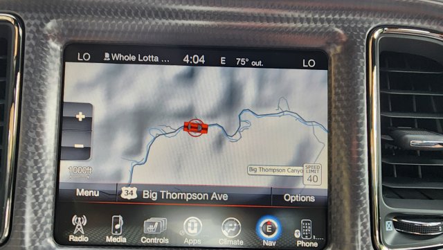

So I've got the issue where my Uconnect refuses to correctly sync with the GPS time (but unlike some others, my location is correct).
I'm trying to avoid the hard factory reset, but will do it if needed, I have done the soft reset a couple of time (press and hold volume/channel center buttons).
Interestingly, while the soft reset doesn't correct the GPS sync clock time, it does change the GPS time. So this seems to have some affect.
Also of note (and typical of others reporting this issue), the time sync error is NOT a full time zone, for example, one iteration was 1hr 38min.
I forget what others have done to fix this? Does this require the hard reset (13second press and hold upper right hand corner of the "phone" screen?) Or is it something else to fix it?
Taken at 2:26pm...

Update:
Upgrading from 17.11.07 to 18.45.01 fixed the clock... ...now lets just hope there aren't new and exciting things to worry about with 18.45.01... : (
