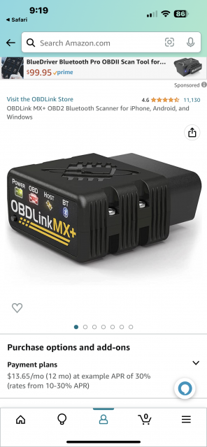

Useful tool but can screwup your car if you don’t take a backup of its config
Don’t seem expensive
8,663
7,635
It isn’t, which is awesome. Not everything has a hellcat tax lol

ELM327 interface
Plus 5 for software?
8,663
7,635
ELM327 interface
$50 for softwar (off their website) and get an obdxii
8,663
7,635
Er, obdmx+
