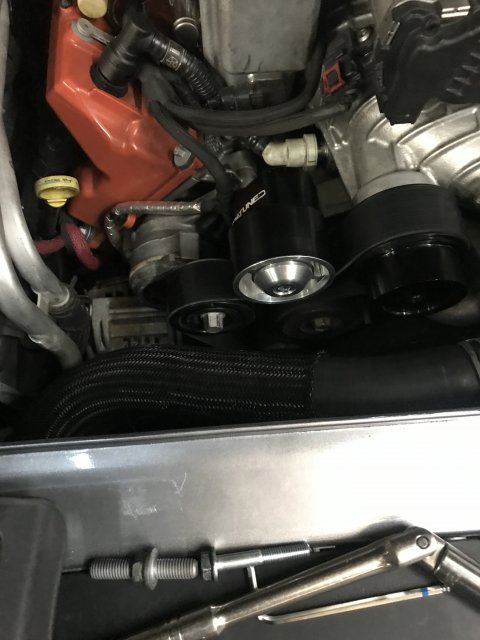

Think I’ll need a longer belt
I had to remove my catch can so I’ll have to either buy a new one for fender mount or figure out how to make mine work 0754D8D4-9F08-4A86-A61B-B6C4040F5293.jpeg
