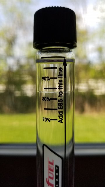

#2284
3
Jacksonville
2016 Hellcat
This is from the station right by my house. I just really don’t want to pay for the dual pump
7,311
19,162
Thread Starter #120
Looks just like mine.
