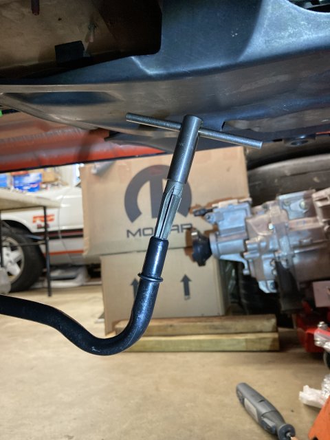

Sure you’re not ready to just follow in my footsteps and get by with just the 2 pumps you already have with just 2 hours of easy labor work??? You don’t need a BAP nor a third pump at your boost level, I’ve proven that out already in my car. I’m running twin 295 pumps, no BAP, stock fuel lines, at 25 psi of boost, 2.84 PR, and 2350 Air Charge, 75 psi WOT rail pressure and my pump DC never goes over 85% on 83%E even at 30 degrees F and -1000 DA.
61,033
213,310
What your fuel pressure dip too? Me, I just don’t like BAP’s, neither do the people who make the pump I wouldn’t think. I’d hang a 3rd pump before I used a BAP but that’s just me. Eventually the stock fuel line becomes too small no matter what unless you raise the pressure even higher and there’s a limit to that too. The restrictions in the supply line design don’t help matters, and they’re easy to remove, again, without compromising line strength or sealing at all. They built them with mass production in mind and to flow what was needed to keep up with stock fuel demand. There’s a reason the Demon and RE WOT fuel pressure was increase verse standard Hellcat it was to make smallish size injectors bigger and get past fuel line restrictions without changing the process in how they were made.
Here’s the first restrictions from the tank to engine bay, like having a restrictor orfice in each end. Easily removed with a reamer, blow line clean with compressed air and done, hour 2 max job. There’s no way removing that stuff can’t lead to an increase in flow at the same inlet pressure, it’s physics not opinion, would something like that be acceptable in the intake or exhaust path anywhere? Of course not. My .O2 at least, a BAP is a band aide plane and simple, a part that can fail, removing the restrictions is permanent and not a failure point as long as one deburs the ends correctly and doesn’t nick a oring in a fitting on assembly, that’s why their rounded, for quick wham bam assembly by folks who don’t care. View attachment 87538 View attachment 87539 View attachment 87540 View attachment 87541 View attachment 87542 View attachment 87543 View attachment 87544 View attachment 87545
The fuel line part under the car it appears the line necks down in the rounded bend from the factory. Optical illusion?
Nope, no illusion, it’s rounded over, it does the same thing at the other end in the engine bay, BIG restriction. Easily removed with a hand reamer.
The stock fuel rails have this same issue and even more restrictions where the bungs are welded to the rails. Get rid of them all and there’s big gains to be made fuel delivery wise.

I'm talking about the rounded bend in the line not at the end under the car.
3,792
8,969
No, I think they made the bend that way to get a bigger radius as tight 90’s are more restrictive then long sweep 90’s. I don’t think it’s necked down there.
61,033
213,310
In the pic it appears it necks down that is why I asked
