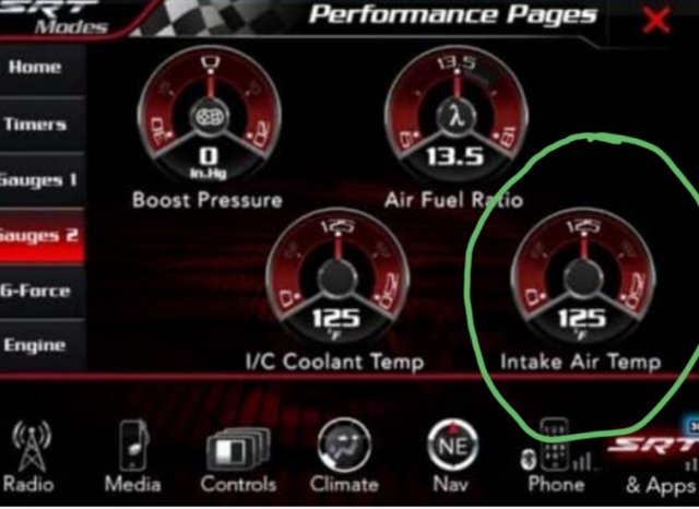

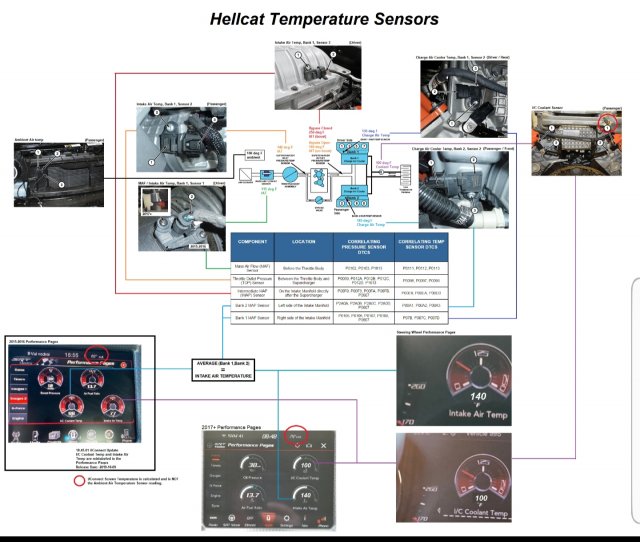

That is the only intake temp I have
If your talking about this gauge I believe it is post or after blower temp. 20210630_154755.jpg
62,270
217,675
Thread Starter #122
That would make sense by what I'm seeing. Needs to be one before it goes in. Sounds like if you data log you can read it
