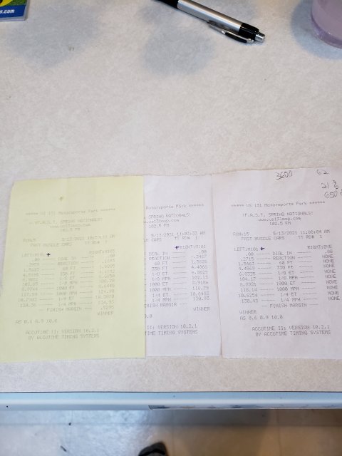

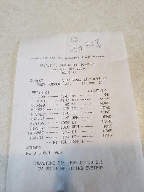

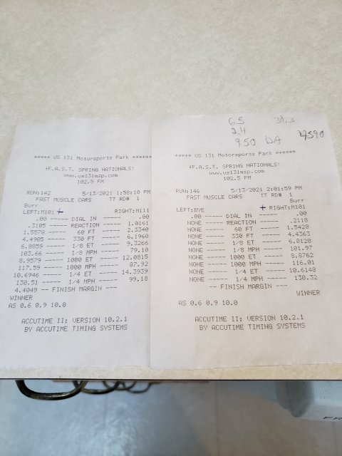

We didn't start running until nearly 11:00 no idea why (I was there at 8) but you could run as much as you wanted to. Made 8 passes could have made way more. Every pass temps were in the 60's and humidity was real low in the 20's. I actually wrote down the DA being the lowest for the JLT but again trying to get an accurate reading on the Kestrel can be tough. Race weight was showing 4600 last pass it weighed 4590. I had a 4 bye passes that didn't help me on hitting a good light on a pro tree being I'm not sure they are watching me. I did 3 back to back to back runs which it went faster every pass. I put the JLT intake on and made 2 back to back passes. Put the stock airbox back on made 1 pass and got all the info I needed. Made 2 more passes a little later back to back with the last being the best time of the day in the worst DA at 900
For some reason after doing my burnout the SRT pages are showing the car going back to street traction from sport. It has never done this before and I didn't catch it on the 1st pass. Every shift the car didn't feel right and it ran a 10.71@130. Next pass I saw it put it back in sport and went 10.64@130 followed by a 10.62@130. Like I said at the start this is 3 passes not shutting the car off. I swapped in the JLT intake and ran 10.69@129 and a 10.75@129. The car never spun but that last pass was also the worst 60ft 1.59. I put the stock airbox on and went 10.65@130. The JLT went 129.9 both passes but the stock airbox went 130.3- 130.9
The DA during those runs were around 500- 650. I'm trying to get all data from my Kestrel but it likes to move around more then I thought it would. Looking online they have the DA about 100 less
Waited about 1 1/2 hours and decided to get a couple more in. I ran the left lane and went 10.69@130 went back around and ran the right lane 10.61@130. At this point the DA was around 900. The best 60ft was a 1.54 which I did 3 times
The 1/4 mile MPH in both lanes seemed to be the same (it has been as bad as 3mph more in one lane) but the 1/8th was showing slower in the right lane 1-2mph.
My findings the JLT was about .05 slower and the MPH was .5 slower. Car sat 40 minutes after making the 1st 3 passes before running the JLT. It sat 1/2 hour before running the stock airbox afterwards. I actually didn't notice the JLT being louder. Maybe because I was making passes with the windows up but nothing jumped out at me. Thought about afterwards:)
The 1st 3 passes are showing up 3 times for some reason
20210513_190430.jpg 20210513_190430.jpg 20210513_190430.jpg 20210513_190331.jpg 20210513_190348.jpg 20210513_190247.jpg

So yes new personal best in worst DA then last fall which also tells me the 3.09's are faster
View attachment 44052 View attachment 44052 View attachment 44052 View attachment 44056 View attachment 44057 View attachment 44058

Awesome report thanks for doing the testing. My takeaway is that the JLT performed as expected with no gain. Lots of variables but basically the stock box is not holding the car back. Still keeping the JLT on though as its louder for me and looks as though it doesn't significantly degrade performance.

If you are happy with it then I don't think the power difference is enough to make a big difference. I'm more of a stock looking car person so I'm happy with the stock airbox
