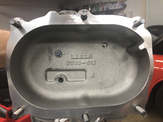

Back of supercharger on gear case cover are 2 1/8” NPT drain and fill/level plugs, they even have little magnets in them.
I’ll post a picture of the cover showing them for you later after I get home

Here you go, the drain unfortunately won’t get all the oil out of the unit, you have to remove the unit and tip it back to do so. I Wouldn’t recommend just changing the oil unless you have the supercharger off since it really can’t be drained properly in place, the oil that’s in it is good for 100,000 miles its said.
