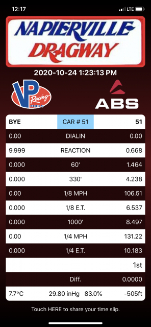

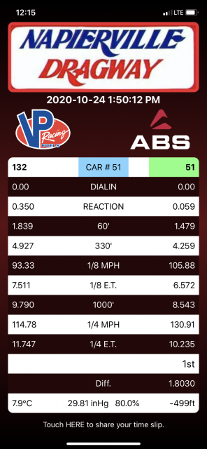

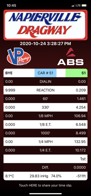

This weekend I drove over 6 hours to Napierville Quebec to run at the best track in Canada. Car is stock with drag pak wheel and tire setup. My previous best at two different tracks were 10.399 and 10.394. Napierville is known for there great track prep. I tried to get a new set of ETRs for this track day but they were back ordered. The grooves were all gone on my tires and the threads were starting to show. I could not find any tires so I had no choice to run the car with those tires.
Saturday the DA was around negative 450–500. The first 5 passes I was struggling to get the car to hook. A few hours later the track warmed up a bit and boom I ran a 10.183.
They were not handing out slips because of Covid so when I pulled into the pits my nephew said what do you think you ran?
I said I don’t know what did I run he said 10.37. I said yes amazing then he said no you actually ran 10.18. I started screaming and freaking out. I said I will kill you if your lying to me you better not be lying. I went to the tower to get the slip and was screaming and dancing like a kid at Christmas.
Then after a few shitty passes I got angry with myself. I did 2 hot laps but blew the tires off and on third hot lap I ran 10.172. Then the street cars started screwing up the track.
Sunday the DA was negative 1500 but it was cold as hell. Struggled again for the first few passes. Got a few 10.2s then did a pass with not a great 60 but I still ran a 10.196. Then again the cold and street cars ruined the prep and it was over.
I am so amazed with this car.
I learned a lot from this weekend. Looks like there is not much gain from running 3.09s on a stock redeye. A 2.62 can go just as fast as a 3.09 and now it went faster then any 3.09.
ETRs get better as they get closer to the end of there life. My PB 60ft happened after I cut a few cords that were hanging off the tire. 1.461 60ft on worn ETRs.
1000rpm is the magic launch number.
21 psi is the magic tire pressure.
I would like to thank Moparjim for helping to get the car to run this fast. His right foot has mystical powers that he has shared with me.
Also would like to thank Hpindy, Oilburner, DemonSRT and Frenchcat for there kind words and support. They always said I could do it. Also would like to thank Phasthemi as he has shared his knowledge with me on tire pressures and techniques.
...and just to rub it in a little to the naysayers NB is faster then WB, 2.62 is faster then 3.09 and granite crystal is the fastest color.;):whistle::D
