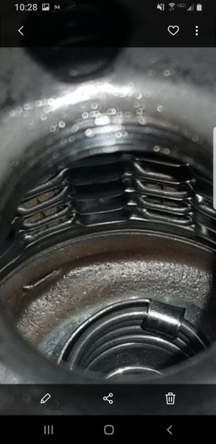

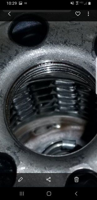

Checked my stock and 2 not good and 1 good. Amazing how they go through the trouble of putting a plastic cap on the end and placing the filter in a baggie but the build quality is so different from one filter to the other. Guess which of these 2 filters looks best.. 😉 Screenshot_20191022-222917_Gallery.jpg Screenshot_20191022-222821_Gallery.jpg

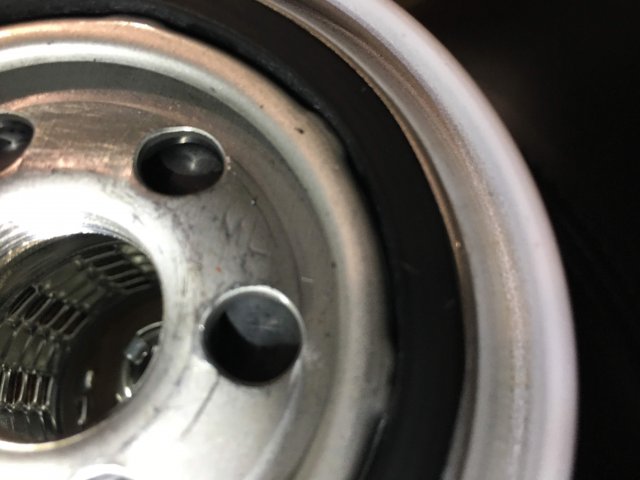

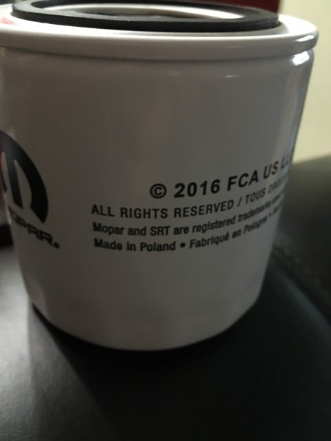

Looking at The one I have on the shelf, I'm seeing the same problem. some of the holes are not open as much as others. appears to be caused by a dull die that didn't cut clean. I believe I can take a small blade screwdriver and open them up little and save the filter. I noted that it reads Made In Poland on the filter! ? Another low cost MFG
Excuse my ignorance but isn't the center the clean side of the filter? So if you use a screwdriver to open slots you may get burr's into the system.
If you would go at it like a baboon you might could. Really not talking about major surgery here!

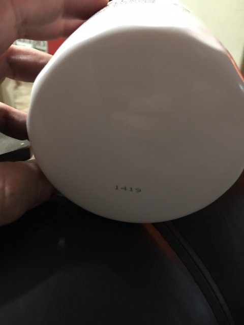

I purchased two of these filters. Put one on last week without looking at it much. The second, well you guys got me looking. It looks okay to me. One row has the, I going to call them louvers, pointed up and the next row pointed down. I can't see how open the down pointed louvers are. What I can see looks clean and open. I'm assuming that the code stamped on the bottom of the filter is a date code? Mine says 1419, made 14th week of 19? Not easy to get pictures but I've made an attempt. 1.JPG 2.JPG 3.JPG

I purchased two of these filters. Put one on last week without looking at it much. The second, well you guys got me looking. It looks okay to me. One row has the, I going to call them louvers, pointed up and the next row pointed down. I can't see how open the down pointed louvers are. What I can see looks clean and open. I'm assuming that the code stamped on the bottom of the filter is a date code? Mine says 1419, made 14th week of 19? Not easy to get pictures but I've made an attempt. View attachment 5171 View attachment 5172 View attachment 5173
I think your openings are about the largest so far.

I also think you're on to something with the date on the bottom.
