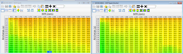

I referenced a Dodge Caraven flex fuel OEM calibration when working on my Hellcat flex fuel tune. Maybe they didn't offer it for 2022 but they did at one time. 3.6L Challenger was FF as well as Ram 1500. Maybe they stopped producing them when the cafe credits went away for flex fuel vehicles or something?

I don't think they published Separate horsepower numbers on flex fuel. But that's actually a great question because the Dodge caravan flex fuel tune I referenced had a boat load more timing in the alcohol table.

For reference, here's the timing maps from the Dodge Caravan FFV calibration I referenced when working on my Hellcat. Notice the huge bump in mid range timing in the alcohol table.
