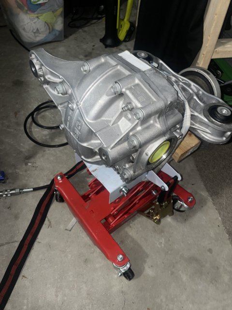

You win some and you lose most of it. Had a long call with GForce. Im going to keep that conversation private till the axles are inspected.
UPS lost my 3.09 in the mail, the new new that @Hatermkr just put together for me. Its like the Devil doesn’t want me to win. Its very depressing.
Onto the good news UPS manages to only fuck up this order half way. Another Diff was shipped, had very distinct this side up arrows and then was reboxed upside down and fucking diff fluid everywhere. After some simple green abd brake cleaner she cleaned up nicely.
this unit is used, will get flushed and then boroscoped, this will be my backup.
