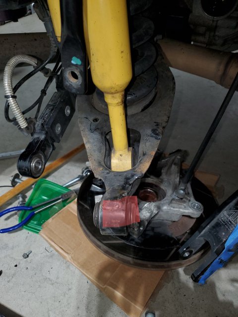

@Wizza thanks for the helpful tips, both ends of the axles all greased up and slid in without issue. it's just that damn knuckle is a bitch to get on. I'll try again next weekend. Next is the AAD rear suspension goodies. Going to drop the cradle for that. Looks like exhaust will have to come down first to get the cradle down enough. Car is laid up until spring, so I've got plenty of time. Your Charger looks great btw.

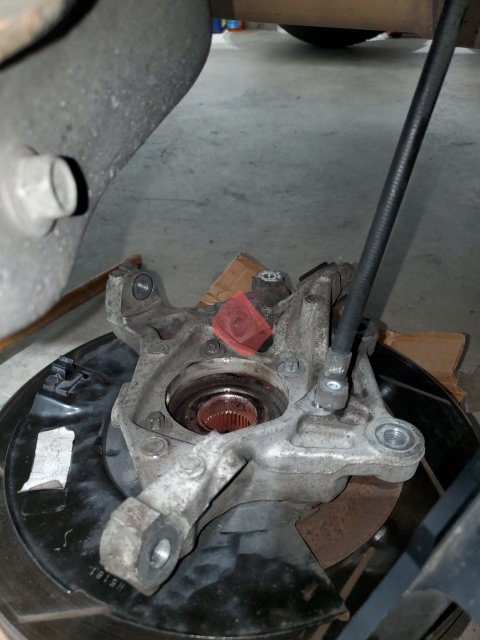

Have you considered using a piece of threaded rod with a couple of nuts and washers to spread that bushing out for clearance ? Pappy always taught me to work smarter not harder
Actually I think that helped me to install the drivers side. Didn't work this time as I stripped the nut doing the pulling. Had to cut it off with a wheel. That sucked. I even tried putting a little heat to it. Still nfg.

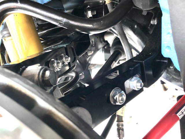

done! Finally. Demon Axles in and a few AAD pieces. I guess the next purchase should be the rear toe arm links or the tension arms? Due to expenses I need to spread out the cost.
