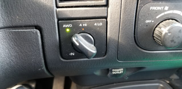

Here is my Durango switch. Guess it is always in AWD? Bought it to flat tow and didn't realize AWD until after the fact.
Excuse it being dirty.
Not always. Not if you put it in 4Hi, 4Lo, or Neutral, right?
Can't remember if putting it in Neutral made it flat towable or not, but I don't think so.
5,877
39,002

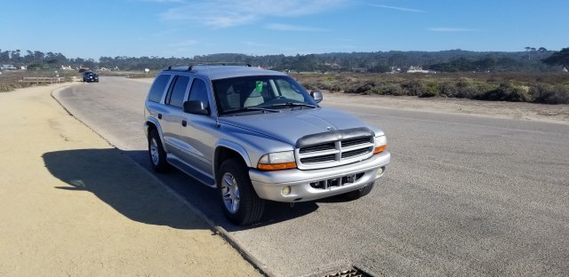

Actually yes, putting the transfer case in neutral allows for flat towing as per owners manual. One shop made a statement about it being AWD and more complex...but I don't know. Bought at 88,500 miles now at 104,000 miles. Been a great adventure car on our camping trips. Actually love driving it (not as much as Hellcat though).
5,877
39,002
Probably have flat towed it 12,000+ miles.

2003 Durango R/T...last year of the 5.9 magnum V8, at least for the Durango that is. Built on same chassis as Dakota.
