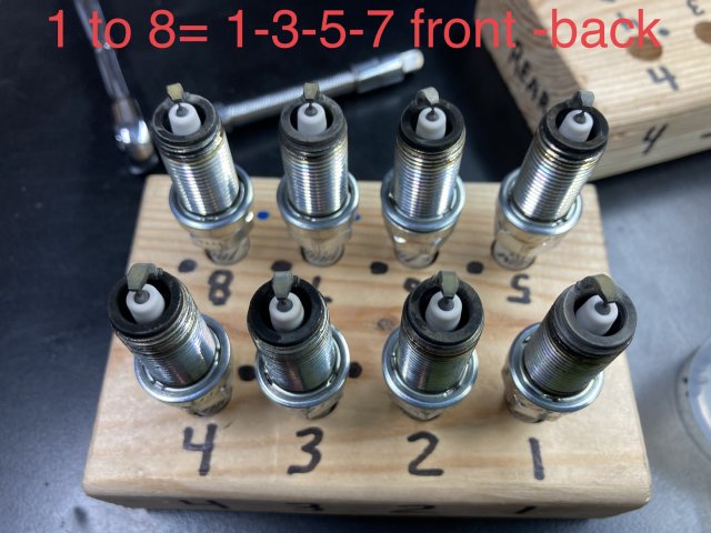

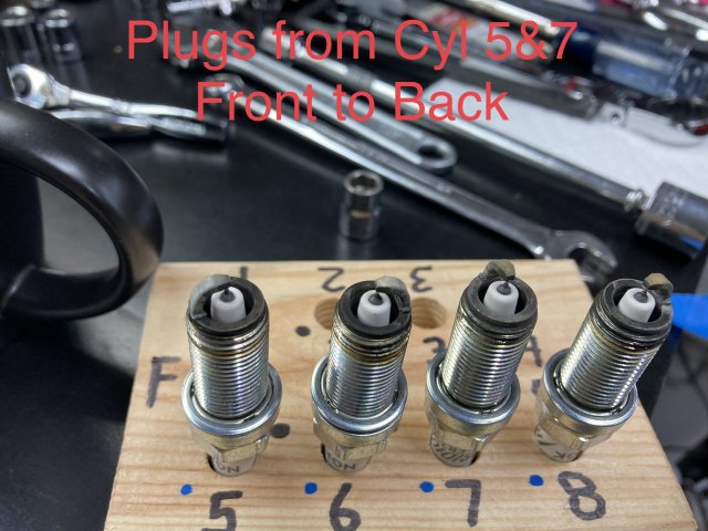

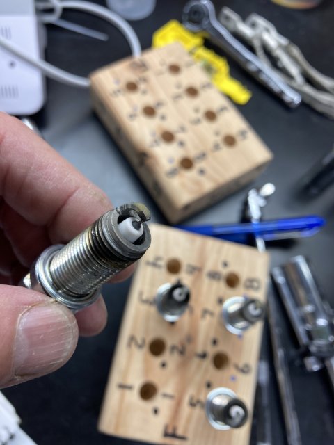

This is the plug I’ve been using for 3 years now too, never gave me a issue, gap them at .028”. Here’s a picture of them after about 2500 miles on corn since new. Notice where the heat band is in the ground strap, about right at the bend where it should be, it can be seen how it migrates back and forth between the root and the bend from part throttle to full throttle operation. Notice the soot ring on the threads, about 2-3 threads deep like it should be. This is 17.5 psi of boost on E85 making about 930 wheel. Engine likes this heat range of plug, I thought about trying a non extended tip type next but this one is running nice why change.

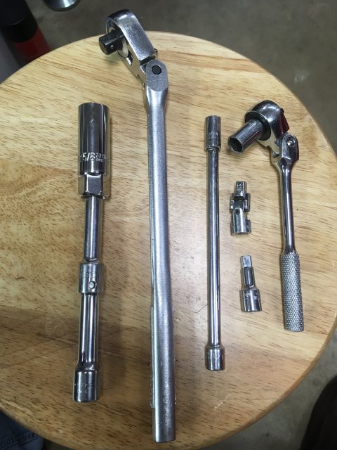

Based on most members here, it sounds like you should do up a dedicated thread showing your tooling setup.
@fumanchu182 about lost his temper more than once doing it.

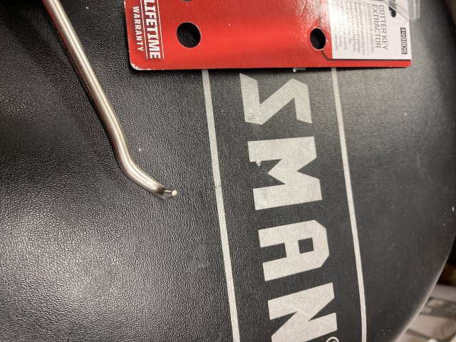

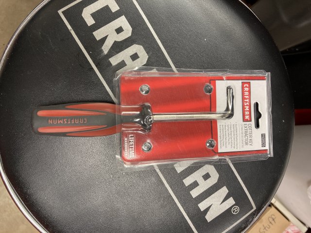

Just saw this, here you go
Use this cotter key remover to push the E connector tab in and push the connector off. Dull the tip so it doesn’t poke through the tab.

I've always been meaning to pick up a set of the articulating ratchet heads. I avoid the snap on truck, any decent brands to go with. ICON, matco, craftsman, dare I say Pittsuburg. I used to be a big craftsman fan but they moved all production to india and I consider myself lucky to have gotten a full set in 2008.
Since Lowes has taken over the Craftsman brand it has improved immensely, I’ve purchased a few of their new stuff from ratchets to ratcheting wrenches, much better then their stuff of the last 5-8 years.
