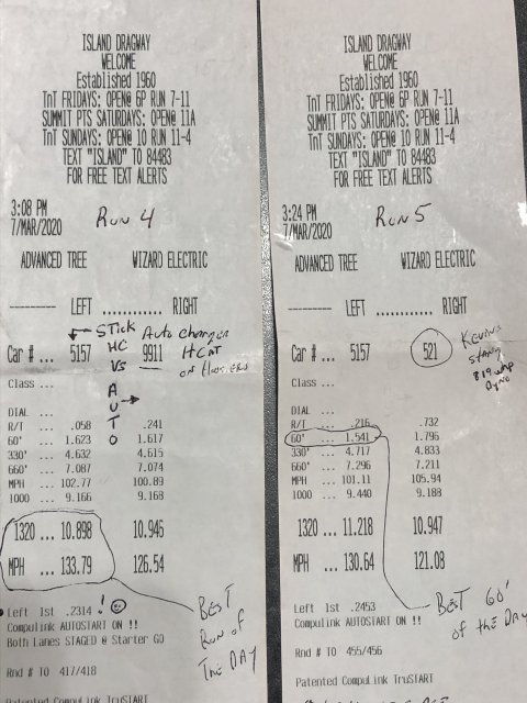

Next stop Island Drag way :) :)
Best run 10.8, best 60’ 1.5
Not bad for first time out this year on a cold track

I ran 5 mph faster this weekend going from 2.62 to 3.09 and also almost 3tenths faster
3,571
8,427
Where’d you run at? My problem is wearing a helmet and rowing my own, can’t hear the car, shifter obscured from view, first time at this track, pavement markings where poor didn’t know where 1/4 mark was and run out is very short with a hard Bumpy 180 at the end. My buddies Stick stang ran a 10.6 at 137 and they side lined him for going over 135 without a cage, thought 9.99 or 140 was the mark for such??

I’m nola this weekend I took 2nd in the heavyweight shootout
3,571
8,427
Cool!! Hats off to you!!
What was your times?

3,571
8,427
Damn, that’s moving!! I’d be happy with a full second and 10 mph slower!!
