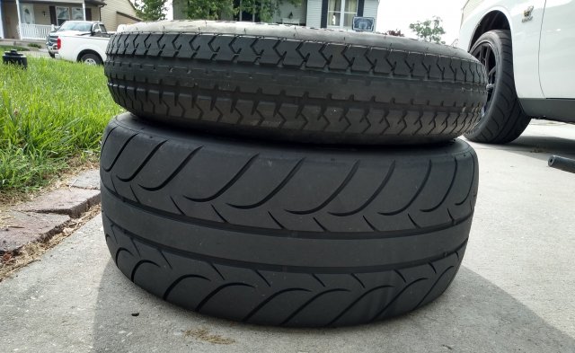

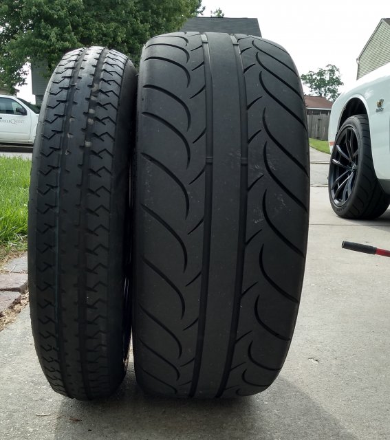

FYI - I was re-installing my drag wheel/tire setup on my REWB today. I had seen this thread earlier and decided to see if my 28" M/T front skinny would fit into my spare tire well. It comes close but just won't go. It might go if deflated.
Just info for the sake of info...

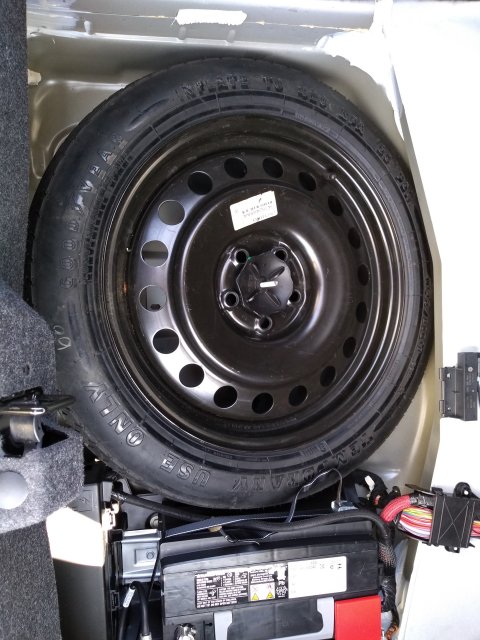

Today I removed the Performance Spare tire (from Performance spare tire co.) I put in my '09 SRT a few years back. I was hoping to transfer it the RE I recently bought. Did a test fit and would not clear the bigger front Brembo's by just a hare. But there's a bit of irony here. Yesterday I removed the rear seat delete from the '09 to put in the RE at a later date and it was determined it saved 48l.bs. Guess what the performance spare and hardware weighed?.....47.5 lbs.!!! So net net it was a wash. If you want the comfort of having a "real" spare and want to keep car same weight, do a rear seat delete. LOL. Just FYI while I had the RE tire /rim off I weighed it. RE rim with stock P Zero (275/40) was right at 57 lbs.
You might be wondering why this became an issue or point of interest on my '09. Short story--- My wife and mother were out a few years ago in her RAV4 and she gets a for real, true blowout. Thank God it was the rear tire. The entire sidewall just disintegrated and shredded.(Dry rot?). I go and change tire. Next day replaced all tires with new B.F.Goodrich rubber. But then I thought "what if I got a blowout, not just a flat?" So I look up spares and found this co. Not cheap (@$300) but fit front and back perfect. They give you a jack but it's sh&*. I bought an OEM Mopar scissor jack off eBay (more money) that worked perfect. Does anyone know if Mopar makes a spare to fit over the huge Brembo's? Would a 300 SRT spare work?

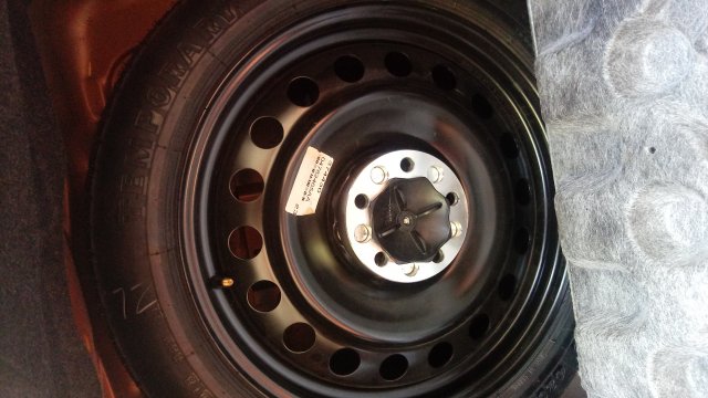

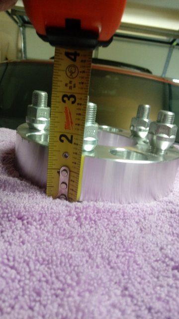

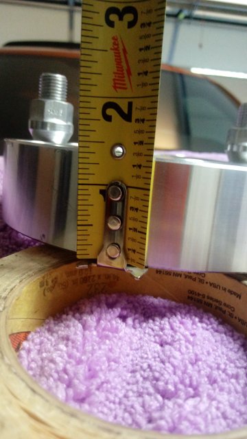

Ok...I found the info and pics from the other forum regarding the spare tire debacle.
This is what he told me about the spacer, and these are the pics he sent me. He has a 2011 SRT 392, and his car came from the factory with a spare and spacer to fit over the front 4 piston Brembos.
Many thanks to Roostking....not sure if he's on this forum or not.
"3 inches to the tip of the lug, Spacer itself is 1 3/8 inches thick "
