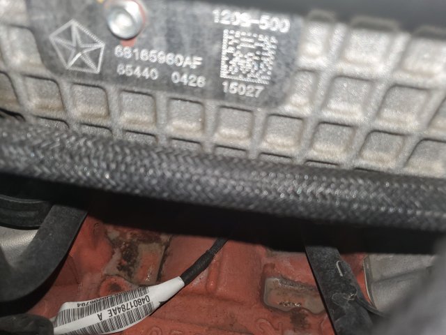

Got the car home today and grabbed a mirror to look at the plaque on the back of the supercharger. Mine ends in AF.
