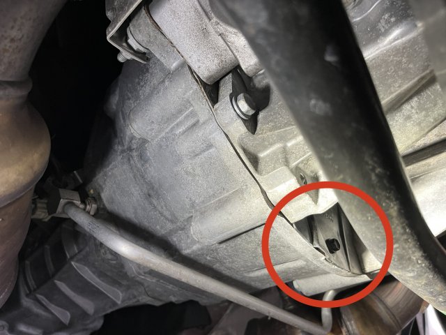

Just reached my phone under the car to snap a pic, might just be the one bolt then slides up and out. Pretty sure this will give you access to the teeth on the flywheel but I don’t remember.

It will, this is what I used for my bolt. jam a prybar in there and then yank on the flywheel bolt. Infinite wisdom before you insert new bolt in. Blow compressed air in there to clean anything out. Had to help a friend tap new threads because he just jammed a new bolt in there without cleaning it out.

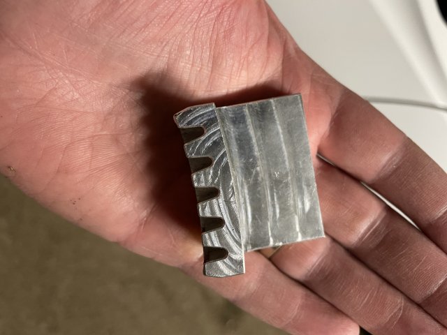

I will surely let you have mine I will have to find it in my tool box I have 4 grandson's that use my tool's also but I'm sure I can find it. You just pay shipping if that will help?

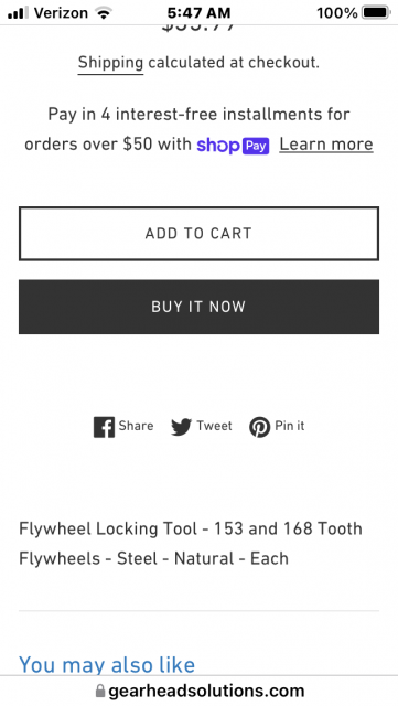

I'll try that next time under the car. Right now I'm showered and done for the day. In the meantime I found the took for 135.00, so not too bad, I guess...
You could try this flywheel locking tool for only $35

I'll be darn found it in the first drawer I opened you may want all 3 piece's if so let me know. I'm a older guy so I dont use a smart phone and wont see your answer till I get home from work 2moro...just let me know

Just bought the same tool Speedy used for a really good price so if any of you guys need it I’ll have it available to you. Thanks for the help.
