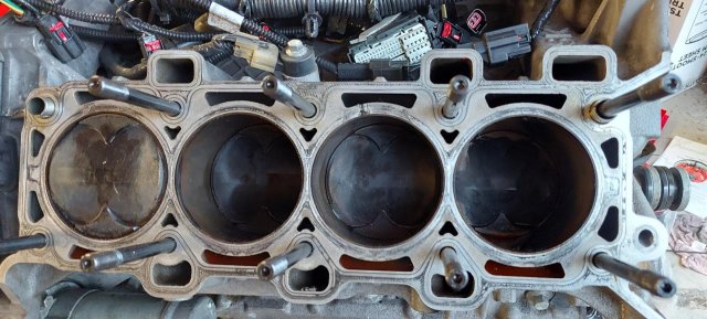

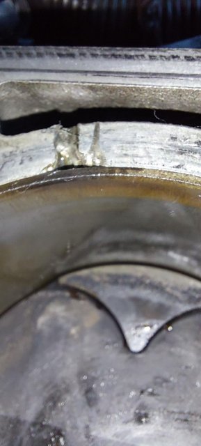

There are a lot of factors in it but I ran as much as 26 lbs on a small block ford with stock graphite head gaskets. Normally if you blew a head gasket it was something other then boost. Having that fuse saves more expensive pieces
This is what blown head gaskets do to aluminum and steel. This was a 5.2 block with high grade sleeves. Used a MLS gasket with 8620 ARP hardware instead of a MLX gasket and 625 ARP hardware. ie cut corners at 28 psi of boost, The blown “fuse” ruined the block and the head.

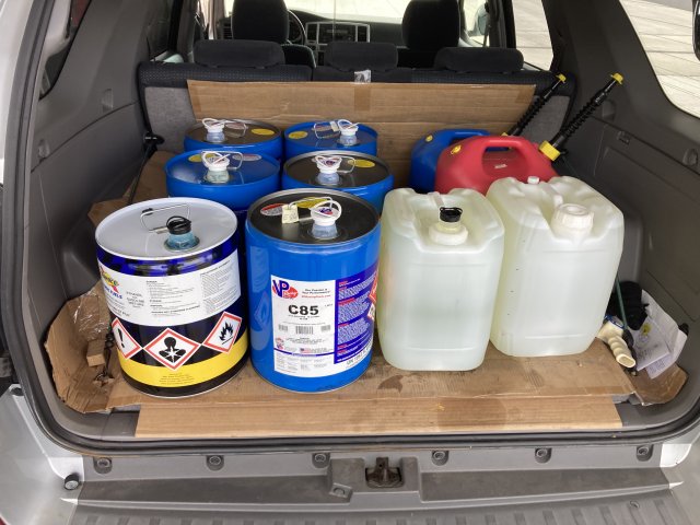

Here's a dumb question from someone who's not familiar with C85. Do you still need to test it?

My point is something caused that not just boost. I saw a story on a build they used cosmetic gaskets on and it went lean. This motor didn't blow a head gasket but took out a bunch of pistons and had to fix a cylinder

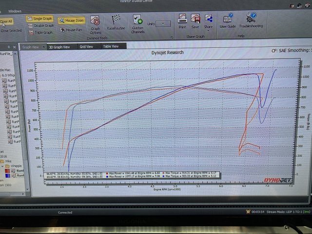

Here’s my results, first pull 19 degrees up top, second pull 20.5 up top and 1 degree added everywhere from 3200 up, 22-22.5 psi of boost. Spun on the dyno top of the second pull, numbers exceeded my expectations and I was out of injector (ID1300X2) and pump (twin 295’s) so there was no point in tweaking for any more. MUCH THANKS to @jonx96 for his help getting to these numbers. There’s more in it yet just need more injector next.

Rocketman!!!
3,633
11,720
#95
Good numbers! Shoulda bought my 1700’s when I was giving them away. 😝

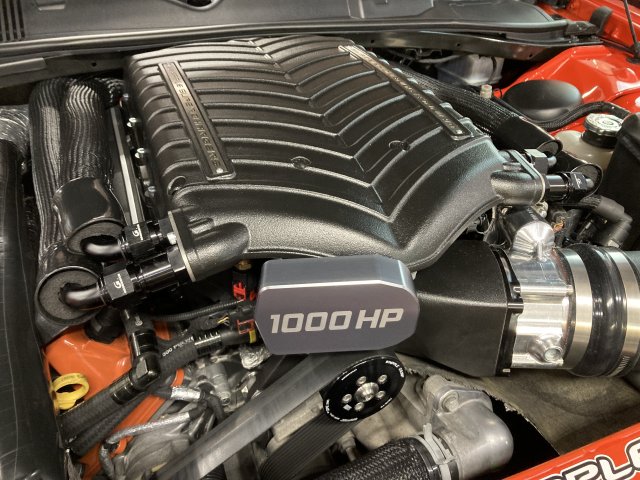

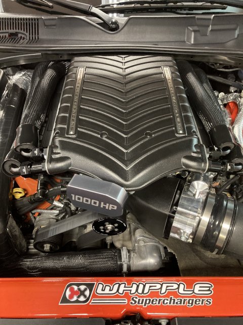

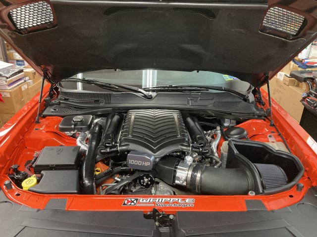

Can proudly display the 1000 HP badge now and those ugly hose ends gone replaced with AN fittings.

What fuel were you running on those pulls?
3,810
9,025
#98
From the Sheets gas station pump Flex Fuel testing around 82%.
I stocked up on it to the other day before the E % starts going down.
