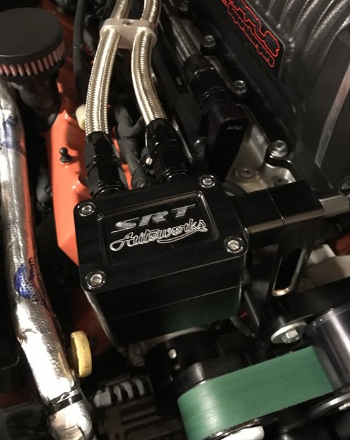

I have the UPR fender mount catch can and crankcase breather(oil cap) combo and I think they are both quality pieces and my car seems happy with them on. Easy install, I let dealer empty it on oil changes and they commented on what a quality unit...
Same here on both Hellcats. Very happy.

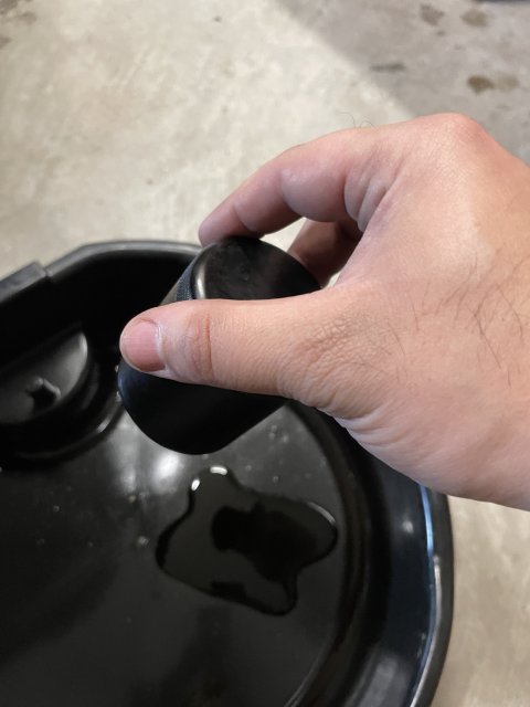

Ive converted to the Church Of Catch Can. I guess once you pass a certain amount of boost no matter the baffles or the design of the valve covers you will get some oil in the system going back into recirc... When I was cleaning out the super charger, there was oil coating a lot of components, and I only had the drivers side can. Since that was in the air charge it was 100% making its way into the chamber. Where was it coming from? Had to be passenger side. Now pushing about 18psi on a great DA day I found this…
F3F1F385-A5A1-426F-B37A-EA65EA503873.jpeg 6E78EA17-9A12-4CAC-9A6A-F169C9D21195.jpeg
First oil change on the new pulley. The above was from the passenger side. However bone dry on the driver side. 🤷🏻‍♂️
Would rather have it in the can then in my chambers.
Just received this one for my ordered Redeye. It's sitting in a box while I wait for a car.:sneaky:
Another vote here for the UPR fender mount set-up
