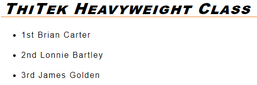

Dave did not win the Heavy Weight class this year; Brian Carter won Heavy Weight.
