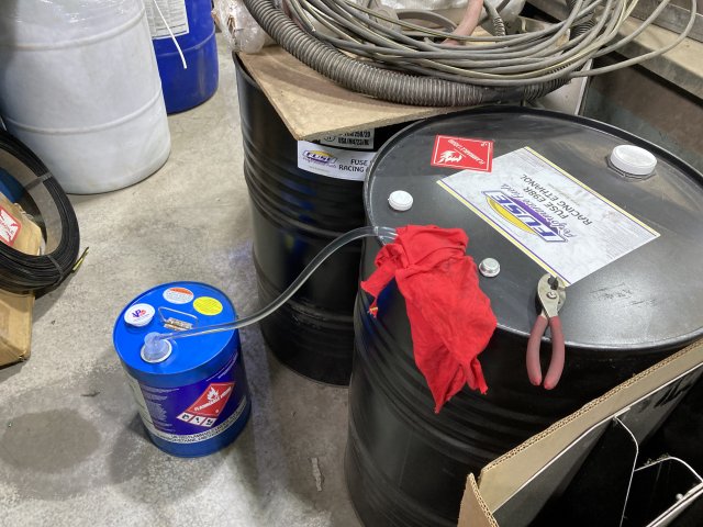

I just do this, good old siphon works just fine to transfer into 5 gallon pails, mix 50/50 with E83 for a E90+ cocktail :) A5A94E5F-9828-44C1-BCFF-8E0EC5330570.jpeg 5443BB54-ABBB-477B-BD32-3468339B03F5.jpeg DB89C8CE-66BC-4A8E-B0A3-1E012107E09A.jpeg
About 99% pure grain alcohol

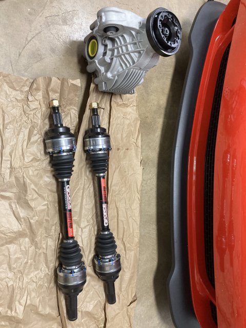

The power of corn!! I made a E83 E98 concoction in prep for dyno day Monday, 10 gallons of E98 into what the gauge said was a hair less then 1/2 tanks, was full with the 10 gallon addition. Took her out, looked over the running log after a hit or 2 in second and third, looked good, felt nice and spicy so I rolled onto it in second and nailed third, it spun, grabbed, and BANG marbles marbles marbles:( Thought I took out an RE axles or the diff as both have been making noise. Coasted to a stop, Looked under the car all looked ok, got back in, first gear marbles, second third fourth fifth sixth reverse all the same, marbles, :( so much for the Tranzilla but it did have a shit ton of street 1/4 pulls on it, the wheel hopping at the track I guess not only put a hurting on the RE axles and Diff but the trans input cluster as well. Called a friend with a roll back, he was an hour out, tried the gears again this time fourth moved the car, I was only a mile from home and got her home and into the garage with 4th. Thank God 🙏
So today set up with RSG to have the tranny rebuilt with all 9310 gears in a 2.66 close ratio variety, 1400 ft lb rated in the Vipers. So now along with the GForce Outlaw axles that arrived yesterday and new 3.73 Diff the drivetrain will be 100% new and better for next time. SUCKS though as I had a Dyno appointment Monday AM to see what she was making, and do some dyno tuning, figures the E85 tune was finally getting almost completely debugged and now another set back :( These cars are parts HOGS (And wallet drainers) Here’s the new goodies, late next week on the trans.
