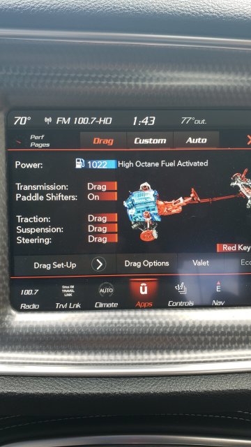

Yes with boostane I got the 420 check engine light on both cars. I have a Redeye with the added HO tuning and button. I just added 1 1/2 cans of vp unleaded to 15 gallons and my HO tune activated. So it picked up 100 octane. Now I need to datalog with it but I'm guessing its truely over 100. 20200620_134315.jpg
Illegal_Demon
#1246
1,723
3,219
Open Space
Yes with boostane I got the 420 check engine light on both cars. I have a Redeye with the added HO tuning and button. I just added 1 1/2 cans of vp unleaded to 15 gallons and my HO tune activated. So it picked up 100 octane. Now I need to datalog with it but I'm guessing its truely over 100. View attachment 19026
Interesting. I haven't heard of a Demon owner saying check engine light went on with Boostane. From what I've read, when mixed properly, the HO light did come on too (i.e. the additive was working). Is the modded RE system you have identical in all ways to what the Demon has? I wonder, with the aftermarket mod (that you cannot hide unfortunately), is the warranty still in effect?
