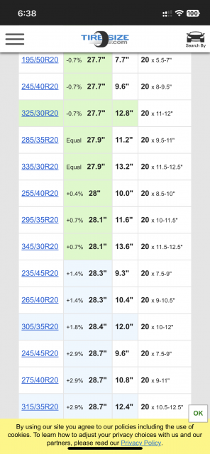

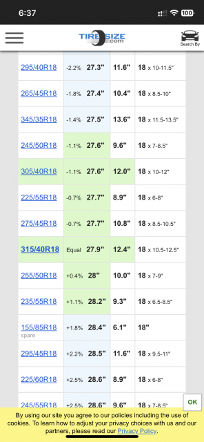

Everybody talking about tire sizes but no one is mentioning rim size. I am assuming these are all 20” rims?? Mine is stock with 18” rims so it has 315-40-18 and came stock with Nitto N05r tires all around. I’ve currently switched up to 315-40-18 Nitto G2s all around for better general traction on real roads, saving the N05Rs for future use or may find a second set of rims.
Doesn’t seem to be anyone making a really good track (road course) use tire in 18” diameter?☹️

Not many sizes available with enough rubber width in that overall diameter. Compare the 12-14” tire widths available, in 18“ and 20”. You see why we talk from 315-345’s in the 20” diameter.
